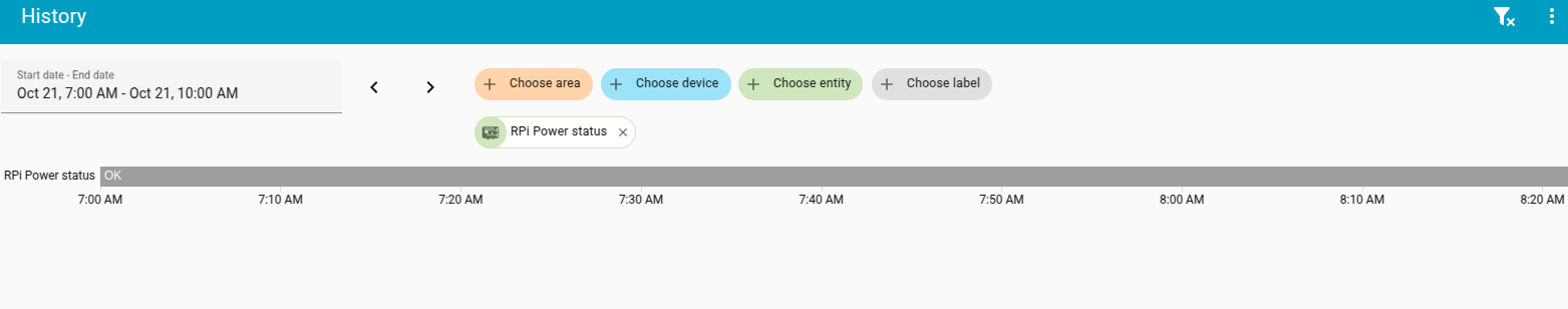

Concerning Power Supply Checker: it is not displaying anything …
