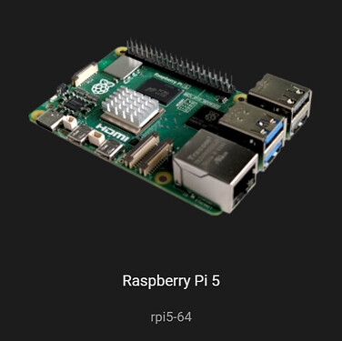

Briefly, here’s my setup:
Raspberry Pi 5, 8 GB RAM
HA 18.0
Core 2026.6.4
Installed via SD card

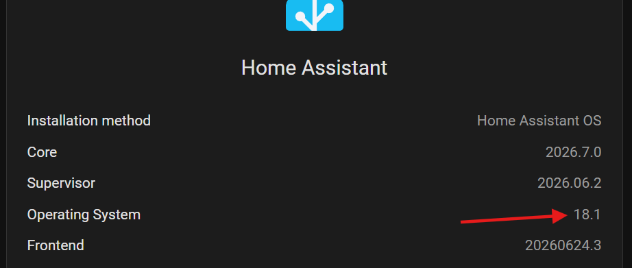

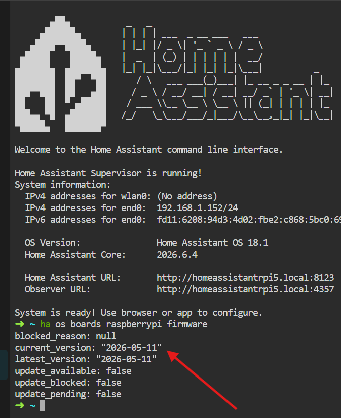

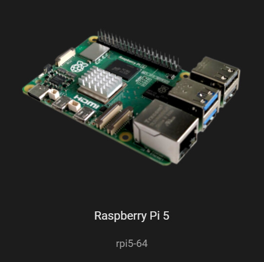

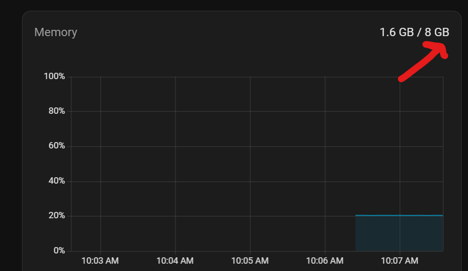

Working fine here... :thinking: So, at least we know the issue does not affect all Raspberry Pi 5 8GB boards.
