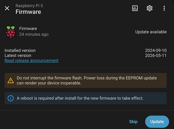

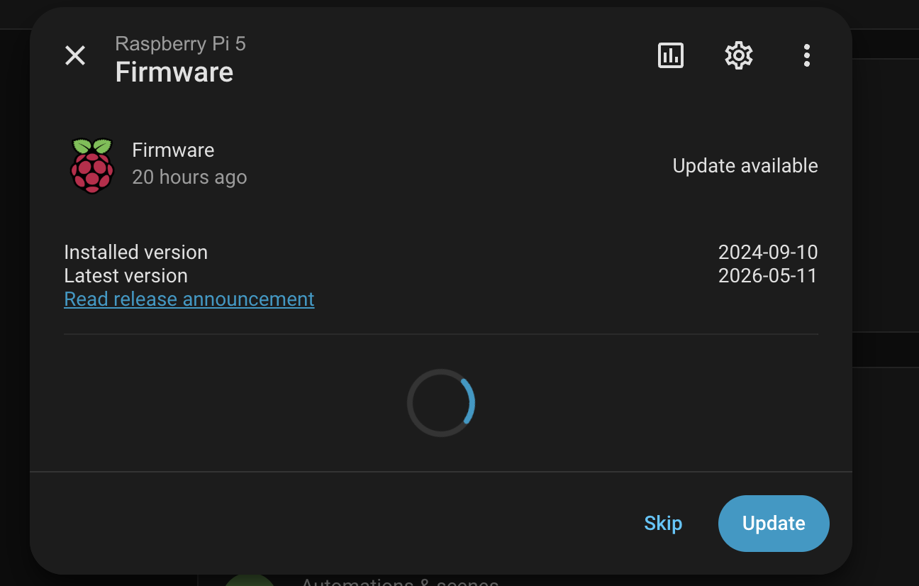

Home assistant indicated there is a Raspberry PI Firmware uprgade, see screenshot.
After the upgrade the platform rebooted but home assistant never came back. After connecting a montior to the raspberry pi I discovered it is booted with the Raspberry PI Desktop!!

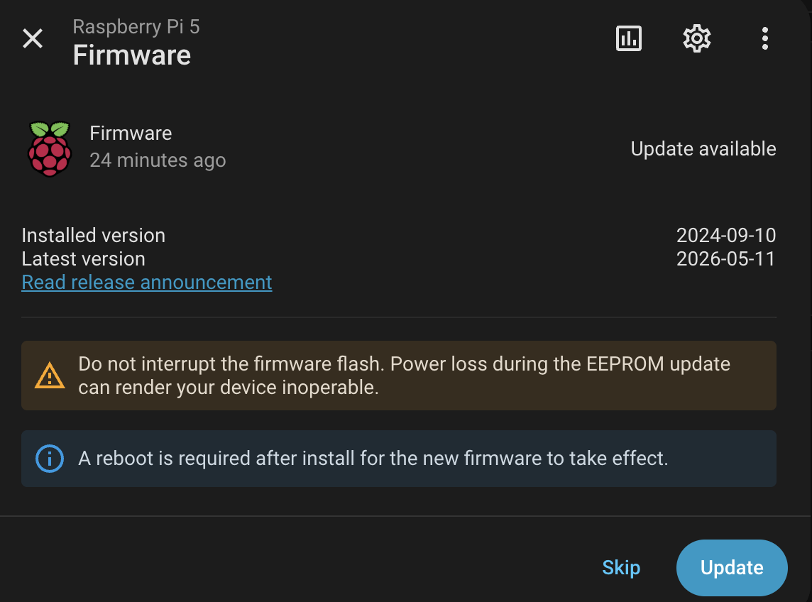

Still q question, why would you upgrade the following:
