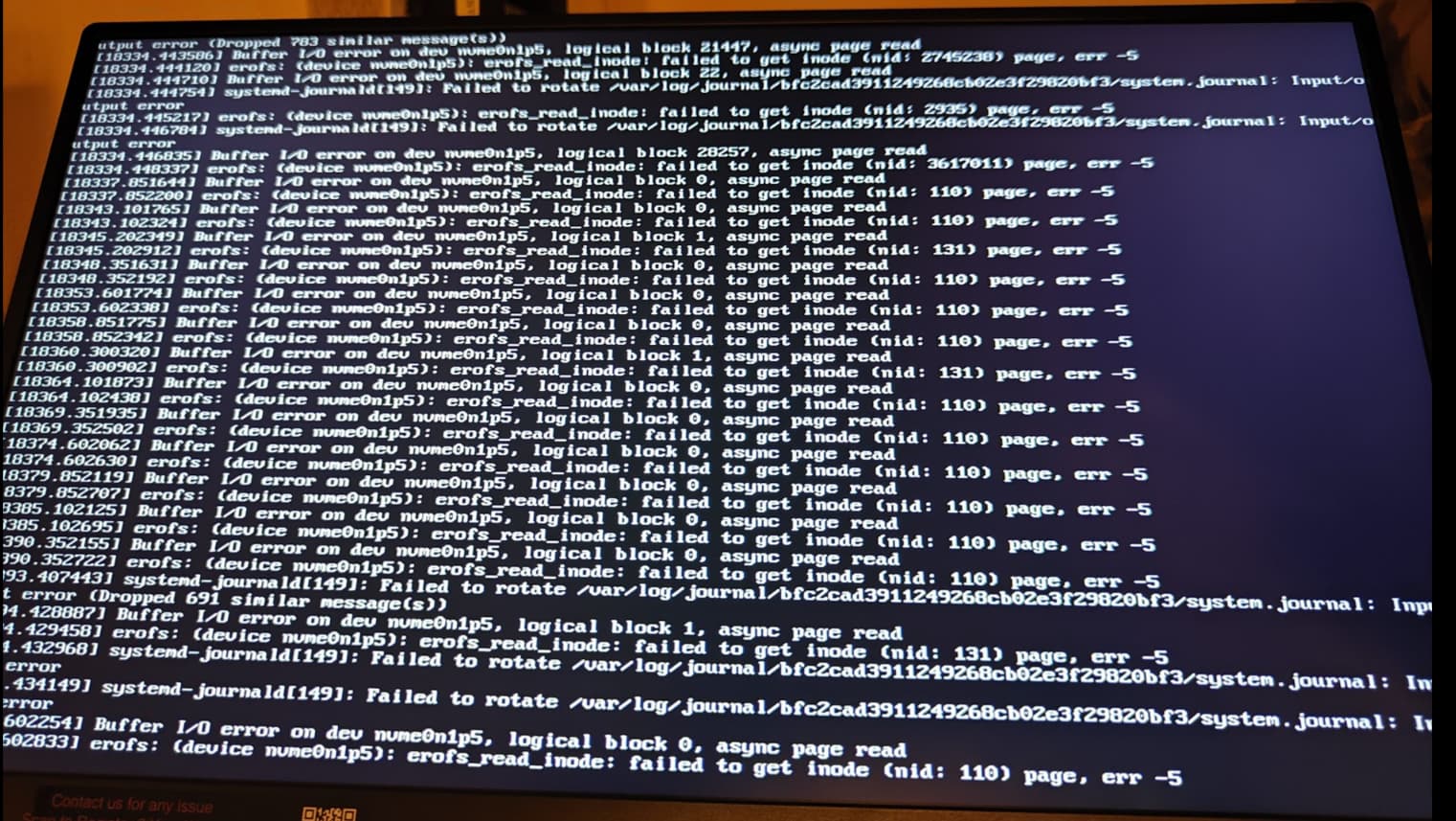

For future solutions i’m trying to setup a Raspi5@4GB with NVME hat, yes “trying, aka dry run” because the machine always freeze and comes up with “erofs” “fs readahead failure” at the ha console.
What have i tried without success.
  • Geekworm X1001
  • Freenove SSDP
  • GeekPi N04
Drives
  • Patriot P320 128GB
  • Kioxia BG4 64GB
  • Netac NV2000 256GB
Raspi Power Supply used
Original 27W Model
Hint: For every round of trial the SSD are written from scratch with fresh HA17 image.
None of them survives more than 12 hours until filesystem errors with freezes appear. The machine get stuck, no remote access, fs errors on ha console

Now i have a 45W PD power supply, removed the cover and the result is crashing with filesystem errors. The GeekPi N04 has a GPIO power help, but seems not help in my situation.
So i read the linked thread and yes exact these are the problems here. Incompatibiolity and lot’s of filesystem errors that most time deny bootup. No reliable work for the machine. My last resort is to try out the Argon Neo case now. Maybe it’s the magic thing, but i will let it dry run for several days until to prove stability.
