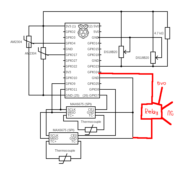

Schematic
This is roughly the circuit used with this program:
Sample Circuit matching this software
