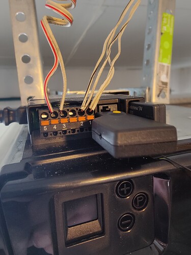

But I’m hoping now to connect the Ratdgo to it and integrate back into Home Assistant. From what I tell, the new GD is Security + 2.0 and think it should work but I’m not 100% sure on the wiring. I have the Ratdgo 2.53i. Connecting the wall mount and sensors into the Ratdgo looks to be the same. But which ‘numbers’ do I connect the Ratdgo Red, White, and Black into the GD opener?
Based on this pic of existing wiring (1 and 2 is the sensors, 3 and 4 is the pad), I think the Red, White, Black out of the Ratgdo into the GD opener would be?
Red=4
White=3
Black=2
