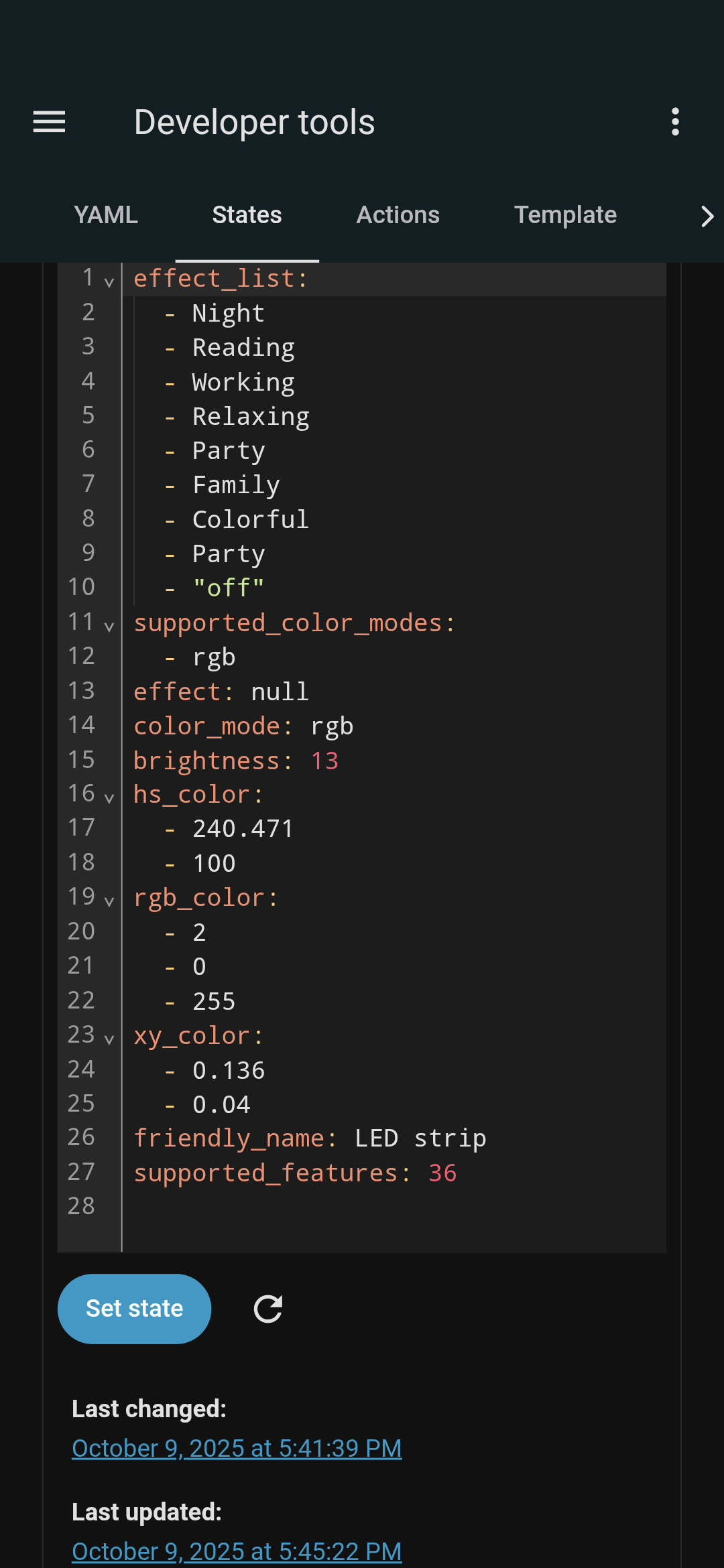

The method I used is using the buttons to set a Meross light to a specific colour and then using Home Assistant automation to monitor the colour of the light.
We can get the state of the light to copy the RGB values. Using automation we can set a template to monitor the light for changes to set this colour
triggers:
  - trigger: template
    value_template: >-
      {{state_attr('light.smart_rgb_led_strip_2',
      'rgb_color') | list == [2, 0, 255]}}
The condition “| list” in the template was critical and had cost me 2 hours of debugging to figure out.
I use it to trigger a switchbot bot, to turn on a dumb AC unit and link triggering this event with the switchbot button state (AC is off, colour is [2, 0, 255], change button state)
Is it stupid? Yes. Does it work? Also yes!

FWIW, the attribute rgb_color is a tuple, so the list filter isn’t necessary if you compare it to a value of the correct type:
{{ state_attr('light.smart_rgb_led_strip_2','rgb_color') == (2,0,255) }}
