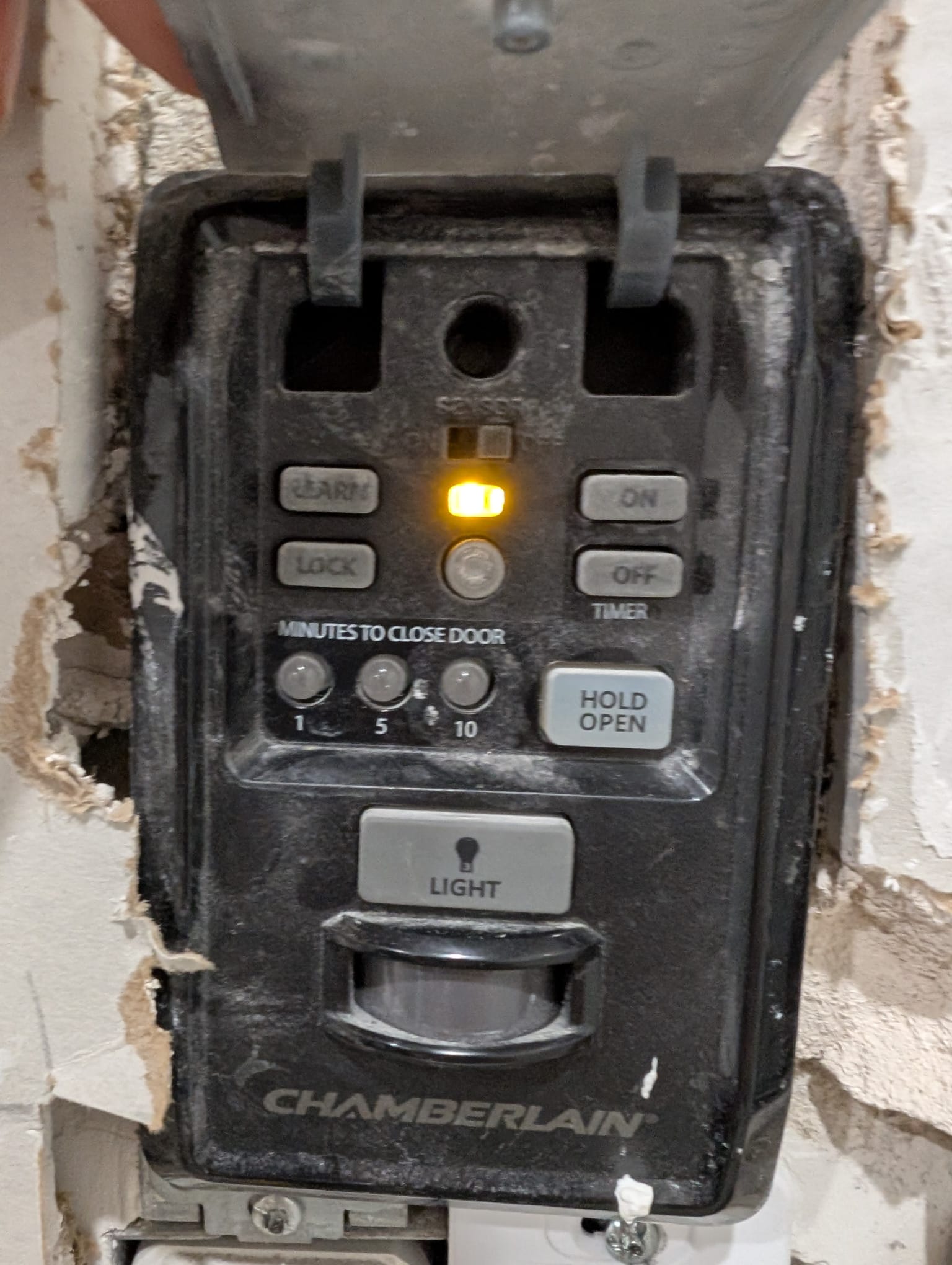

This is the wall panel I have now.
I do need something there to get the WAF. But I’m worried the one I have isn’t going to play nicely.
And it’s a craftsman with a purple learn button.

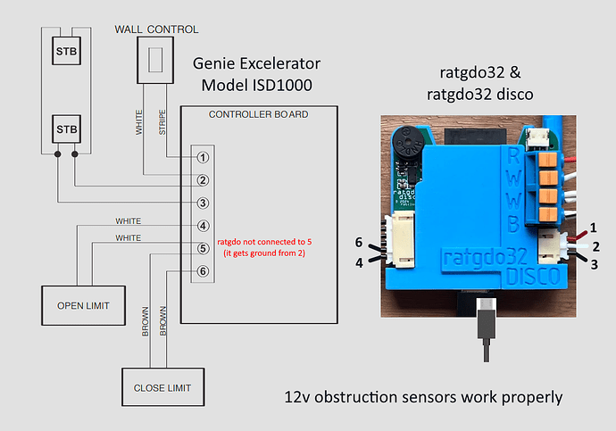

I was using a ratgdo V2.5i in dry contact mode with my Genie Excelerator (model ISD1000) for over a year and that didn’t work with the obstruction sensors as they are 12 volts. But with the release of the ratgdo32 which supports a wider obstruction sensor voltage range, I ordered one and installed it last night. The obstruction sensors work properly and update instantly in Home Assistant, and I thought I’d share the wiring diagram in case anyone is searching.
