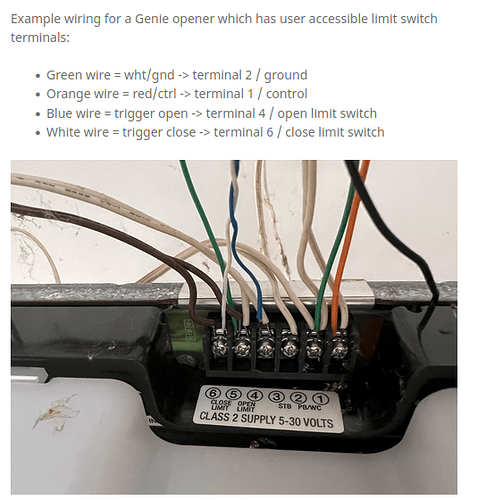

Im trying to setup a Gelidus Research RATGDO v2 with my Genie IDC990 with dry contacts. I have HA showing the open and close position correctly but it will not operate the door.
I have it connected like this.
