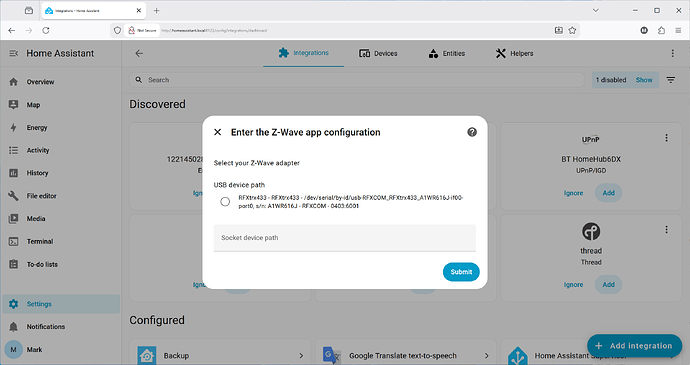

ttyAMA0 seems to be active if i use ls -lha /dev/tty* but when i try to install Z-wave, it does not detect anything on AMA0, keeps listing a 433mhz device on a USB as the only option.

Thanks, I can get the longer path, thanks for the info, but were do i put it? The z-wave app doesn’t let me enter anything?

The only option that appears is the RFXcom device…
You can’t just type /dev/ttyAMA0 where it says Socket device path? (Sorry if that’s a silly question.)
Isnt that my point. It’s not detecting the Razberry. The AMA0 port is active. Ive tried a couple of different baud rates etc, still nothing.
