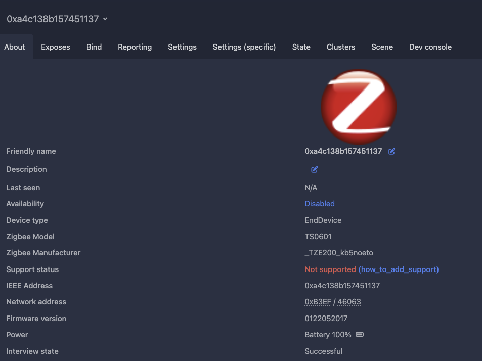

I have a PIR+mmWave sensor from Tuya that I was using for a good while until recently the battery died. For some reason it didn’t just reconnect when replacing the battery so I decided to Force Remove the device and Repair it. After enabling Permit Join, it can find the device but shows unsupported now.

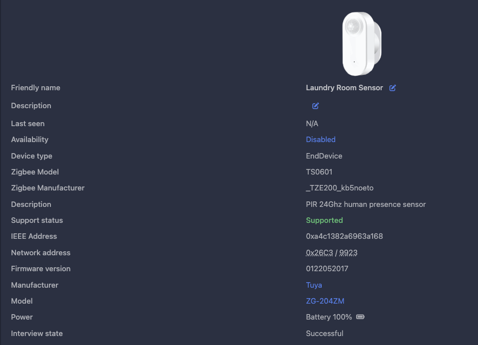

I have a 2nd identical sensor still being used in my Laundry Room, and as you can see below it’s supported just fine.
Not 100% sure why or how this happened, but any advice here would be greatly appreciated!
