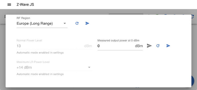

I’ve set the RF Region to “Europe Long Range” in Z-Wave JS . I’m seeing nodes assigned to IDs like 255/256, which confirms LR is active. However, the signal from the cellar is struggling to reach the 1st floor.
Has anyone successfully “bypassed” two floors of reinforced concrete using Z-Wave 800 LR without intermediate repeaters?
Are there any specific Z-Wave JS settings (transmission power, etc.) I should tweak for the ZBDongle-PZG23 to maximize penetration?
