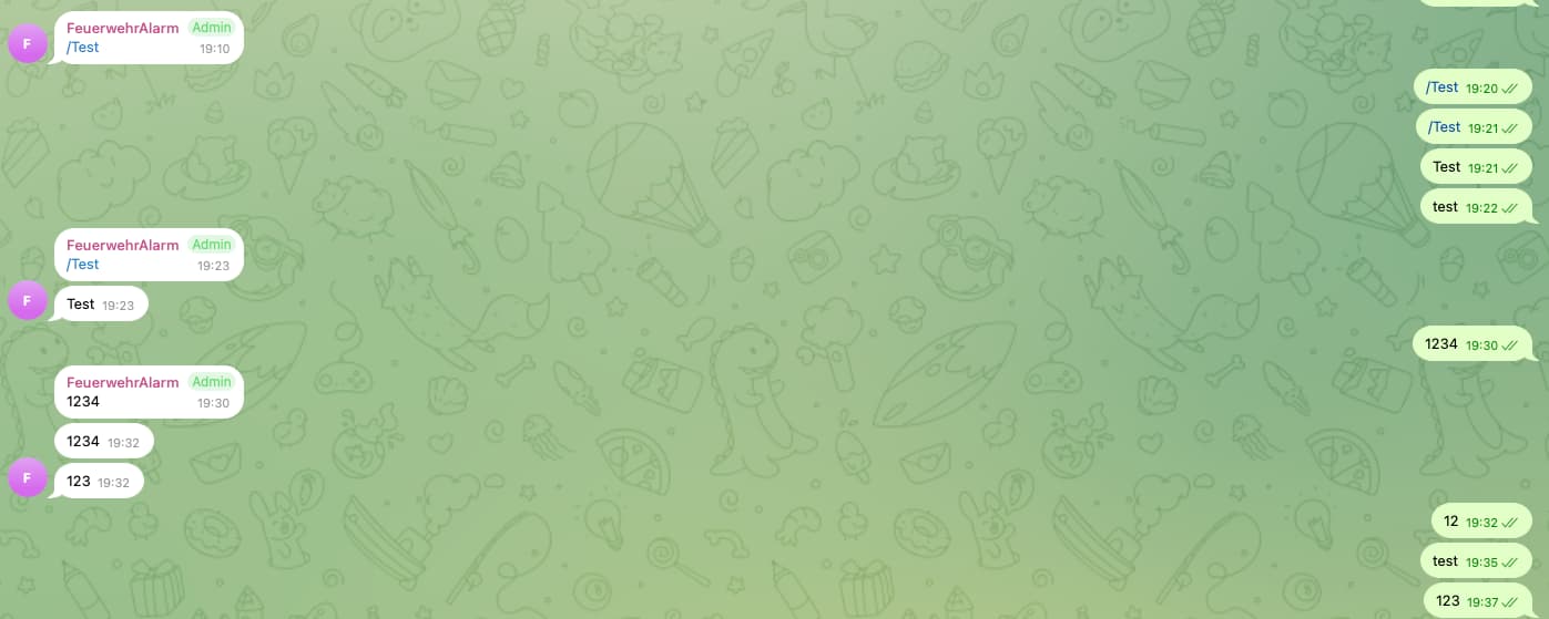

With this command the alarm app for the firefighters sends a message into my Telegram Chat.
(https://api.telegram.org/bot14xxxxx:xxxxx/sendMessage?chat_id=12860xxxx&text=Alarm)
When sending any text (see right side of the picture) HA sens a Pong respones in another chat. But when FeuerwehrAlarm sends a message nothing happens.
