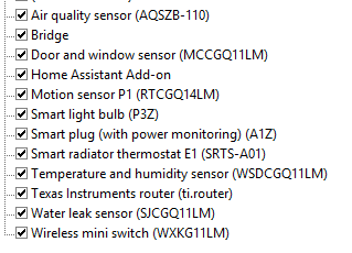

i have an template, what prints alls existing mqtt entity Ids with additional infos.
in the past i got results for model ID with attribute model names in brackets with this script?
now i get back without model id, but with the exact same script?
i had documented the used template in my excel, so im sure it was exact the same…gues i had made an zigbee2mqtt update in meantime…
any chance to include the model id again? i would appreaceate to have it in seperate columns… in the past i had to extraxt it from model name in excel… but now i would be happy to have it anyhow…

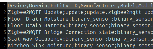

This version reports model_id in parenthesis within the model column. Example:
Smart light bulb (P3Z);
Device;Domain;Entity ID;Manufacturer;Model;Area;Integration;ID

Neither version produces two leading blank characters.
