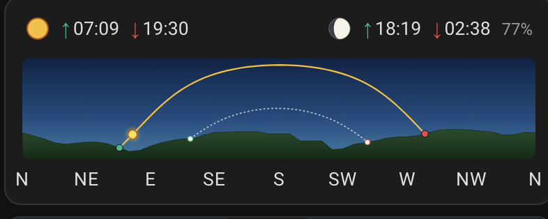

Real Horizon fetches the 360° terrain horizon for your HA latitude / longitude from https://re.jrc.ec.europa.eu/ (free, no API key, SRTM-derived, global) and computes the moment the sun actually clears the local horizon. Same for the moon. Comes with a Lovelace card that draws today's sun and moon arcs over the silhouette of your real horizon.
What you get
  • sensor.real_horizon_true_sunrise / _true_sunset — terrain-aware timestamps
  • binary_sensor.real_horizon_sun_above_local_horizon — useful for "only run automation while the sun is actually visible"
  • sensor.real_horizon_sun_clearance — current sun_altitude − horizon(sun_azimuth), in degrees
  • sensor.real_horizon_local_horizon_profile — the full 360° profile + moon position + horizon-aware moonrise/moonset (consumed by the card)

What i propose is not limited to user elevation. It pulls from pvgis a full horizon profile around your location. My place is deep in a valley. If you don't take into account the relief around my place, these days, sunrise is off by one hour, sunset by two hours. And it's not even that dramatic a landscape, this is not Yosemite, just a valley in hills. This is not the ~3min induced by refraction and solar disk size. It essentially make these times useless for automation. With my integration, i get at ~10min. No configuration, and a cute (I think) lovelace card.
If you're on flat terrain, sun will work fine. If there is a building or a tree somewhere, my understanding is, you can hack around it with sun2. But if the dominating feature determining your horizon is terrain, I think this integration can help.
