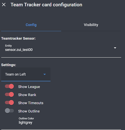

Is this when setting up the card? What does it look like? I’ve had one other person say something as well.
This broke with the new UI introduced in 2026.1. It should be fixed in v0.15.0 of the TeamTracker card.

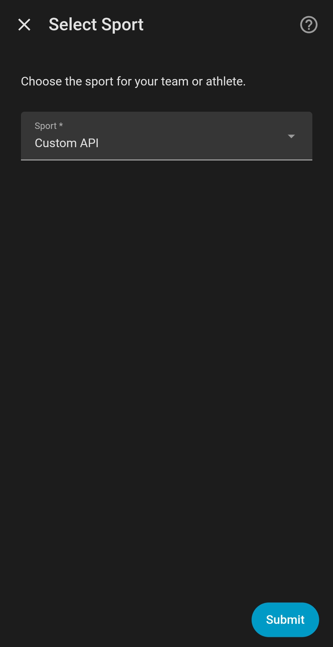

How do you add that? I'm using the integration. Edit: nevermind it's in relation to cards and not the original sensor. Crazy that an integration focussing on football/ sport doesn't allow the ability to track the whole competition with a wildcard for the team.
Add an entry as follows:-
  1. Sport = Custom API
  2. Sport Path = soccer
  3. League Path = fifa.world
  4. Team Name = leave blank unless you want to follow a specific team
  5. Team ID = whatever you want to call it

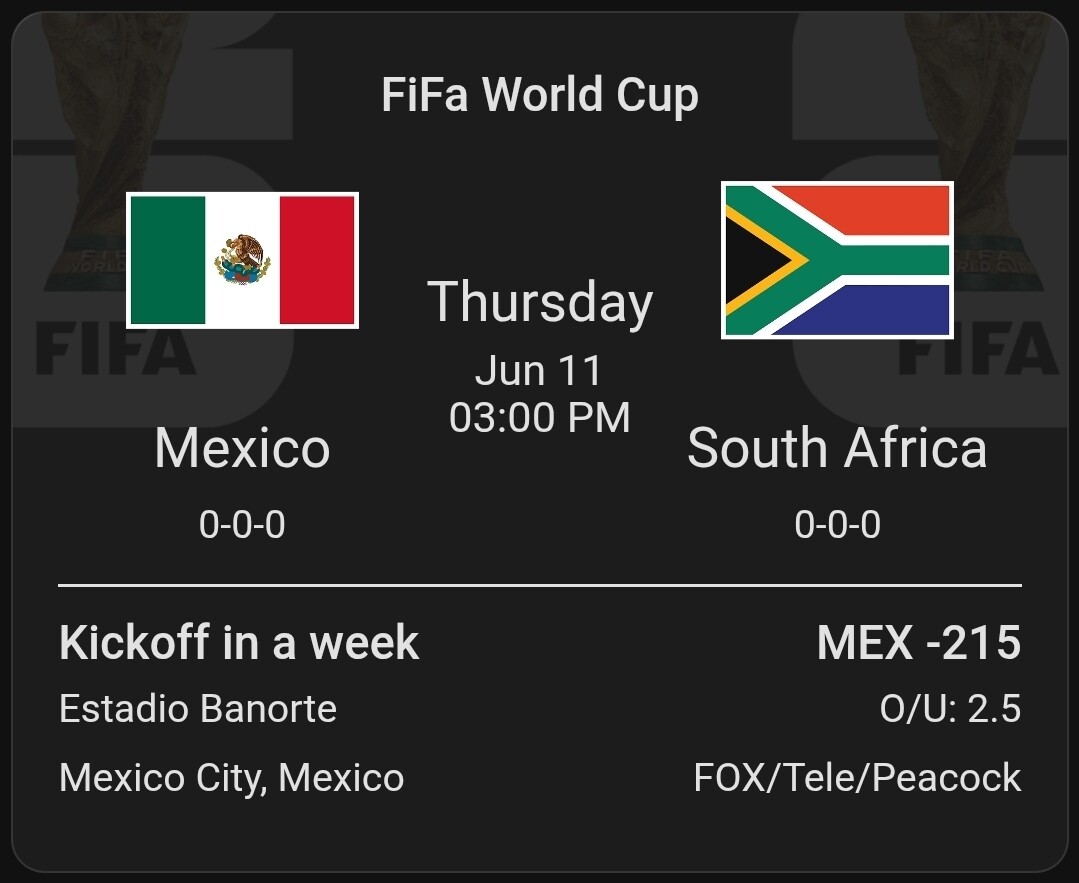

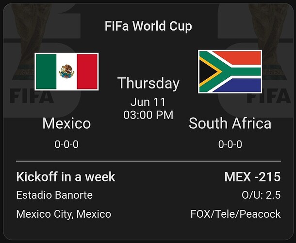

My main dashboard displays the "Today's Match" card like the one shown below:
Currently, clicking on either team (the flag or the name) opens a new tab and navigates to that team's ESPN profile page, which is fine.
However, I want to configure it so that clicking or tapping anywhere else on the card (or just in the space between the flags) navigates to a different dashboard view ( http://homeassistant.local:8123/football ), which displays all upcoming matches:
I also don't mind losing the current links for the two teams if that makes things easier.
I've tried a few different approaches using AI but haven't been able to find a working solution.
Does anyone know how to achieve this?

Use the Code Editor in the card to directly edit the YAML and add the desired URLs to the configuration keys bottom_url, team_url, and opponent_url as desired.
Example
type: custom:teamtracker-card
entity: sensor.zui_test18
debug: true
show_league: true
bottom_url: http://www.google.com
team_url: http://www.espn.com
opponent_url: http://www.fifa.com
If you are using AI and it doesn't answer immediately, you can try pointing it to the README or the Wiki. The information was there and it might have been able to pull it out.
