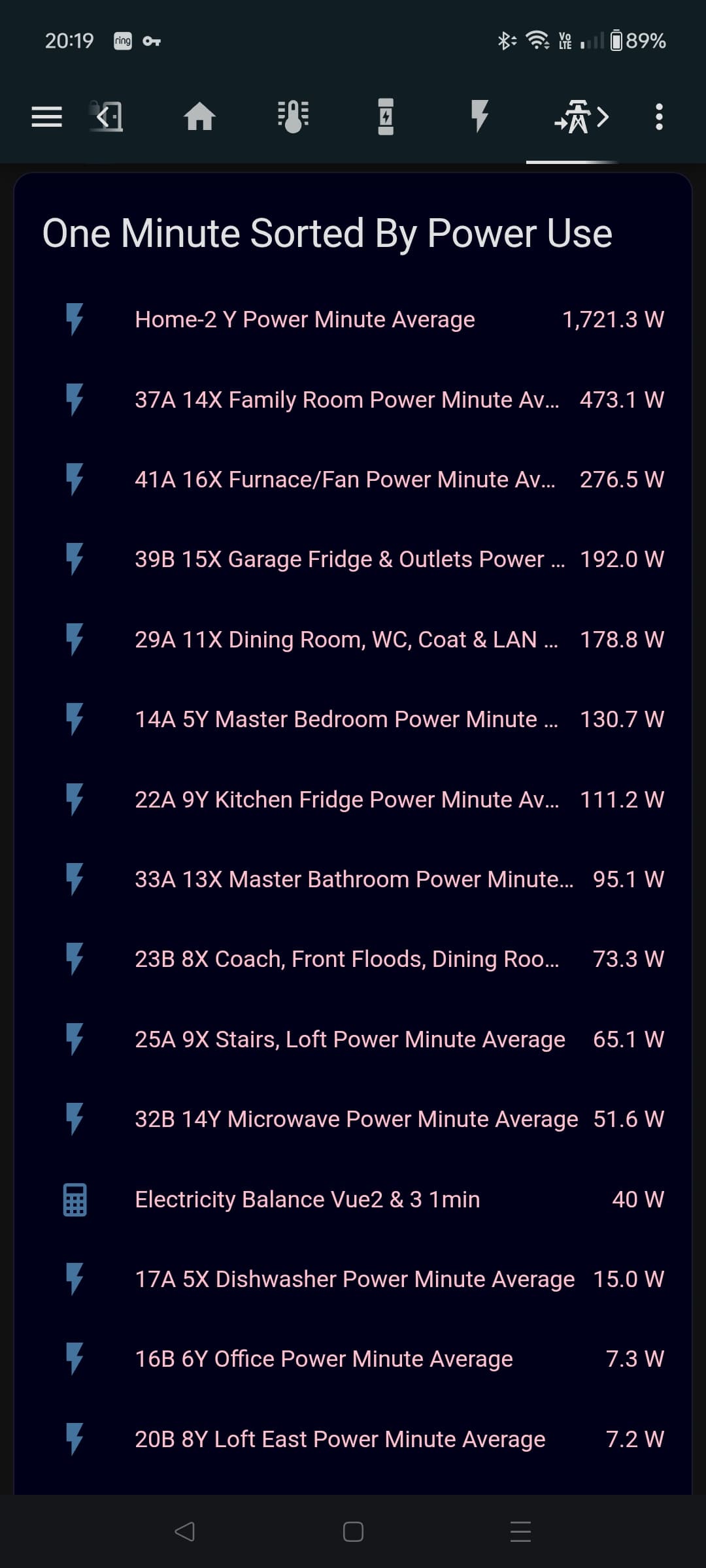

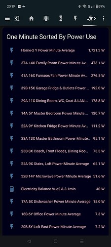

I am using two Emporia Vues to monitor my electricity consumption. For one Dashboard I use the auto-entities card
to display one minute values sorted by power consumption. This is continuously updated. Almost real time.

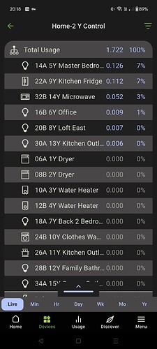

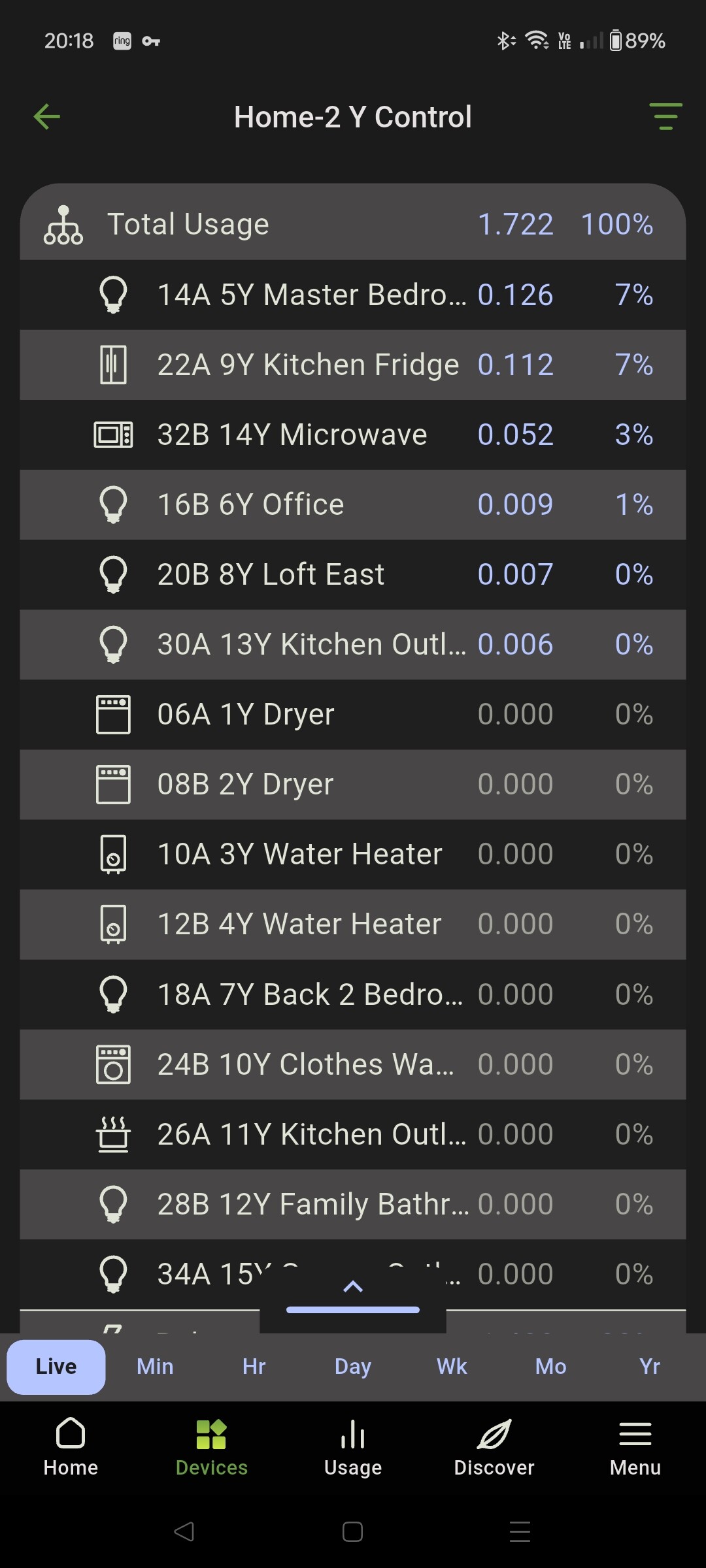

I would like to also display the CT sensor power as a percentage as these change for each sensor. Currently there are 31 sensors (i have one spare). Ideally I would like the percentage displayed on the same line as the power value and to change as the values change. Also I wish to keep the list sorted, high to low.

Thanks for your reply. Each device (breaker) has 3 entities. These are all in Watts or Kw. They are Month, Today and Minute Average. I fear that I shall need to try your suggestion of addin up all the Watts and generating individual percentages for each breaker and time period. That sounds like nearly 70 Helpers if I include percentages for the two incoming phases. I am not sure I want to maintain all of those.
I had thought to do this before I posted and I posted because I did not want to have 70 Helpers I still don’t want them. I think that I shall live without percentage values. After all, I have Excel.
