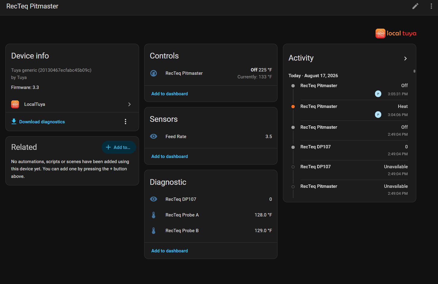

I’m also able to start the grill from an HA dashboard button. I verified that the state actually changed on the grill itself and wasn’t just changing optimistically in the HA UI.

1 Power / remote start Read/Write
102 Target temperature °F Read/Write
103 Current grill temperature °F Read
104 Feed rate Read
105 Probe A °F Read
106 Probe B °F Read
107 Unknown Read
109 Unknown Read
110 Unknown Read
111 Unknown Read
DP 103 returns null when the grill is off. That’s normal.

DP104 is the feed rate
This took me longer than it should have.
DP104 is the 1-AUG setting from the grill controller menu.
The range is 30–250.
The grill controller displays the full value, while the app displays it divided by 10.
For example:
Controller: 65
App:        6.5
The app also won’t let me set it below 6.5, so anything lower has to be set directly on the grill controller.
If you want LocalTuya to display it like the app, set the sensor scaling to:
0.1
That gives you 3.5 instead of 35, for example.
It’s a setting, not a live reading, so don’t expect it to change while you’re cooking.

The Home Assistant climate card is optimistic.
You can press Off and the tile immediately shows Off, even if the grill never actually received the command. The next poll can then change it back.
I got fooled by this more than once.
When troubleshooting, don’t rely on what the tile says. Check the actual device state, raw_state, or the recorder history.
