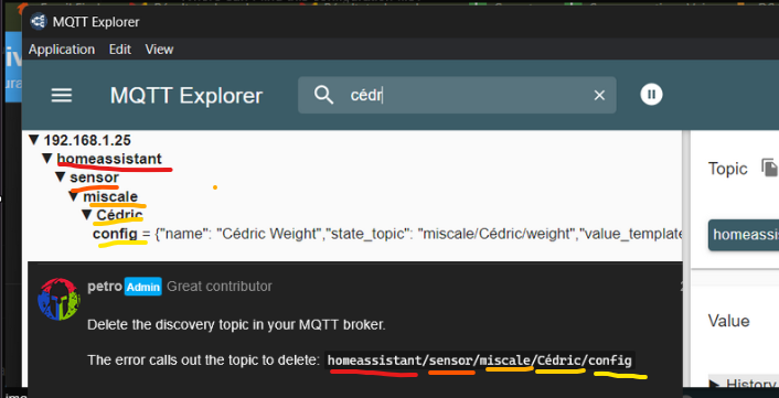

Delete the discovery topic in your MQTT broker.
The error calls out the topic to delete: homeassistant/sensor/miscale/Cédric/config
If it’s stubborn after clearing that topic and restarting, you may have to use something like MQTT Explorer to clear the topic.

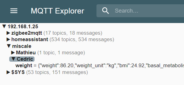

Hello, I can’t delete it; it’s not present in the MQTT broker.
I just deleted it in MQTT Explorer.
Check after a restart that it doesn’t come back. If it does, it’s stil in HA somewhere and HA posted it in the broker again.
I successfully deleted it via MQTT Explorer, yet it keeps reappearing.
