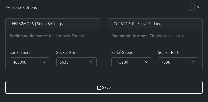

Recently purchased an SMLight SLZB-MR4, set the SL radio to Matter-over-Thread, and the TI radio to ZigBee. Connected the SLZB-MR4 to my IoT VLAN via PoE (so not using USB - lets me position it anywhere I have a network port).
Installed Zigbee2MQTT, MQTT broker, and got ZigBee going without issues. I installed Thread and tried to install OpenThread Broker integration, but when I give it http URL of static IP and port of Matter-Over-Thread as shown by SLZB-MR4 web interface, it times out with an error…

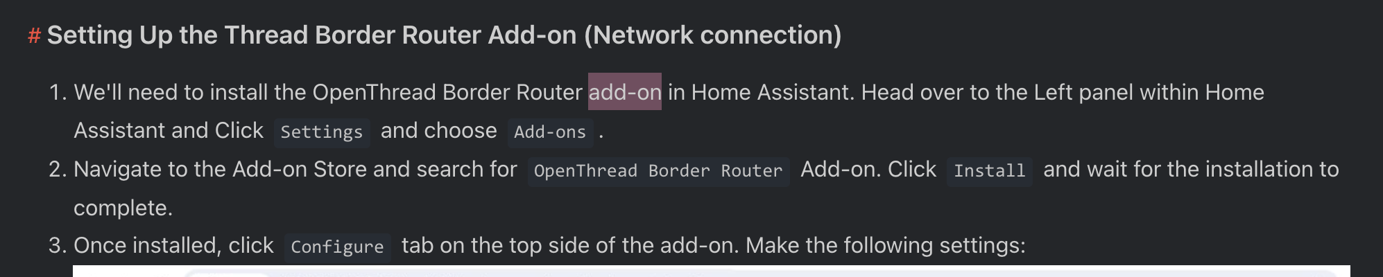

As I understand it, you have to install the OTBR add-on separately, and then pass it your radio. You can then configure the Thread integration in Home Assistant to communicate with this OTBR instance.
A guide I found: Connecting Matter-over-Thread Device to Home Assistant | SLZB-06 * Series Manual

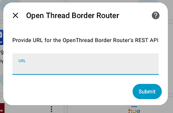

    Prompted for API URL: “Provide URL for OpenThread Border Router’s REST API”
  5. I provided http://192.168…:6638
  6. Dialog comes back with “Failed to connect”

As you have mentioned, the prompt is asking for the “OpenThread Border Router’s REST API” URL - have you deployed openthread border router? The instructions I linked above walk you through on how to do that.
The URL you are providing (http://...:6638) is not the OTBR URL.

So in HA, an integration is separate to an add-on.
Integrations are installed into Home Assistant itself; the open thread border router integration expects a URL to an open thread border router server.
An add-on is a separate app that spins up as a container, adjacent to your HA installation. The URL that the integration is asking for is the connection to the add-on.
That’s right. The OTBR add-on (the actual border router software) will ask you to provide the details of the radio it will use. Once you have that running, you can pass the details of the add-on to the integration.

I think that’s fair enough - though, I do think that the website that I linked does spell it out quite clearly; however, I don’t blame you if you glossed over it and thought it referenced an integration instead.
Out of all the options you posted, I think just running the container is the easiest and least hassle :slightly_smiling_face: it’s well worth getting used to running extra containers so you become more aware of the moving parts required for your setup (and there will be more containers you have to run down the line anyway)
I can’t vouch for this one specifically (as it is the result of a cursory search), but there are a multitude of options out there to try make it easier to run the container: GitHub - ownbee/hass-otbr-docker: Stand-alone Home Assistant OpenThread Border Router docker container.
