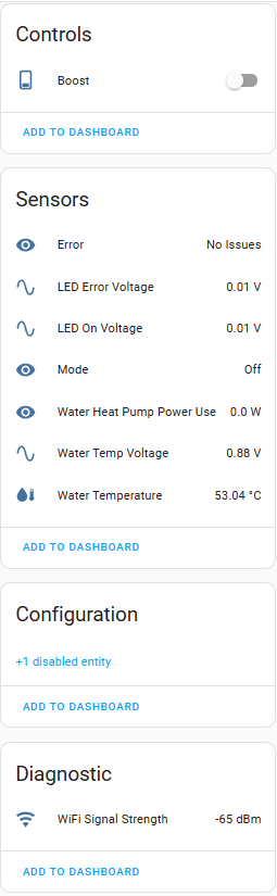

For those of you with a v1.1 controller, I have just finished adding mine to Home Assistant via the ESPHome integration and an ESP32-C3
It needs some more work but overall function are fine and gives you control over boost functions, shows water temp, current state (off, run, boost), and warning of errors.
I tried MANY things including a lot of time spent trying to interface to the PIC controller they use, the serial and MOSI, all of which failed, they just never implemented any of it in the PIC logic unfortunately.
It’s actually much simpler than I was initially thinking of, uses the onboard connectors for everything apart from a soldered connection to the rear of the Run and Error LEDs.
I’ll create a separate post on it for those that are interested
