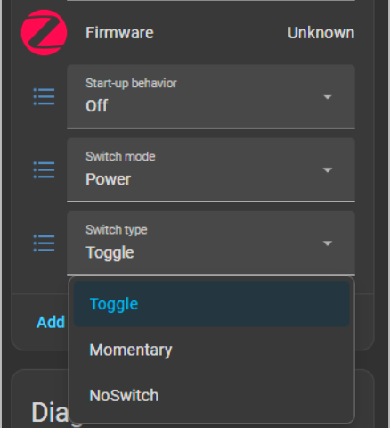

You can install a relay behind the switch and set the input mode to momentary then bring that relay into HA.
Thanks for the reply. What kind of relay supports momentary mode? And do I need 2 relays?
Most relays should have the option to swap the input modes when they are added to HA and you will need as many as you have buttons you want to connect in different locations or get ones that have more than one input and output option based again where you want to and need to set them up.

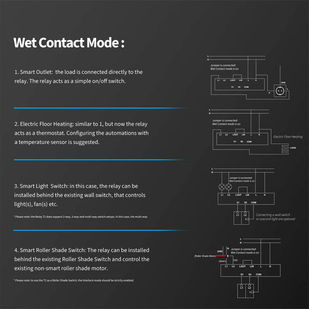

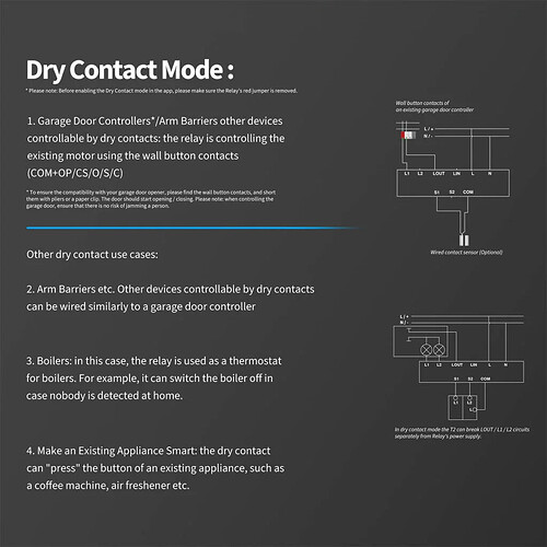

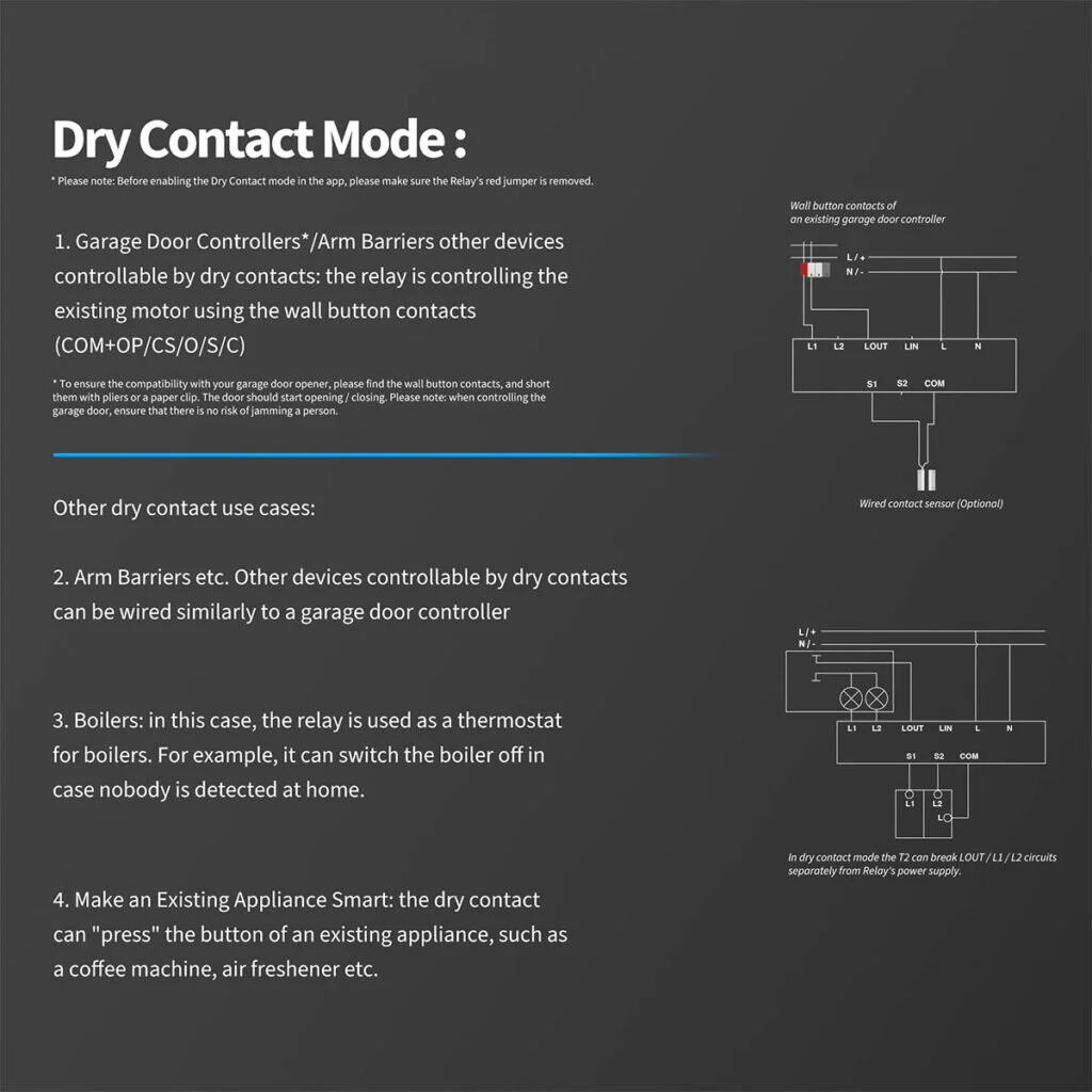

The relay that I have at the moment to give you an example of one is an Aqara Dual Relay Module T2 which has the following options in HA:
  • The jumper wire needs to be connected to L-IN and L-OUT for wet contacts mode
  • The jumper wire needs to be removed before enabling dry contacts mode
I pre-configured mine before having a certified electrician install it behind a power socket in my case.
