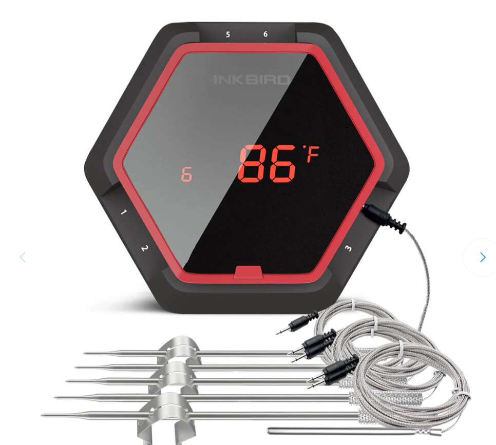

Inkbird integration
Sorry I should have asked in the first place...
Which model?
I'd like to use a wireless version and I see them on Amazon but I'm not sure if that version works with that integration.
I got this one:
INKBIRD Bluetooth BBQ-grilltermometer med 6 prober IBT-6XS

Well the one I linked to is not truly wireless.
It has wired probes to a battery powered brick that you can charge with USB C (I'm 99% sure about the USB C part).
The brick has magnets to that you can attach it to the BBQ
