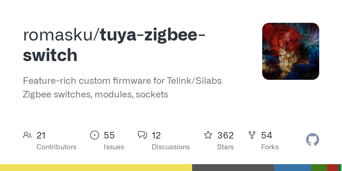

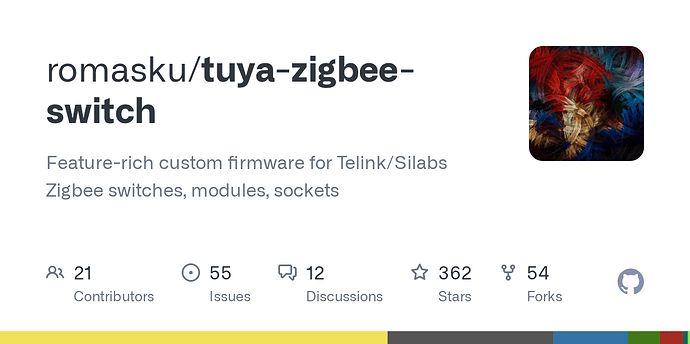

I’ve got this device specifically, but I’m assuming it can’t get into no wattage mode?
Normally tuya switches has only basic features, but you can enable smart bulb mode, binding and others by flashing this custom firmware
