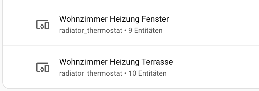

I have two heating valves (Euronics Spirit via homee integration).
One of those lost an entity (in my case the valve position).
I have removed and reconfigured the integration already, but still no valve entity for one valve device…
How could I force home assistant or the homee integration or the device to reload or recover the sensors?
(I’ve checked in MQTT-Explorer, that both valves have 10 entities.)
with the integration of homee into HA Core, the valve position number entity should have been replaced with a valve entity.
That the two Thermostats behave differently is strange.
Maybe you can post the Diagnostic data of the two devices here:

Hmm, the only difference I see is that the second one has an additional control for wake up interval.
Is it possible, that the valve entity is hidden or disabled?
Meanwhile figured out, that the missing entity isn’t the valve value; it is the “Aufwachintervall”.
The valve position is available as an attribut.
I had mixed up two observations: I had disabled the homee2mqtt integration, lost the valve position and (wrongly) combined, that this must be the missing entity. The “Aufwachintervall” might have been never there.
The only academic problem left: Why is the valve position no more available in the homee2mqtt integration for one valve although it is for the other? - But thats academically because I ran your integration.
Sorry for inconvenience.
Question:To display the history of an attribute value, I need to create a additional template sensor or is there another way to show this?
I’m not sure how the valve entity behaves in regard to history data.
But normally I think attributes don’t store history - so you will have to use a template sensor.
