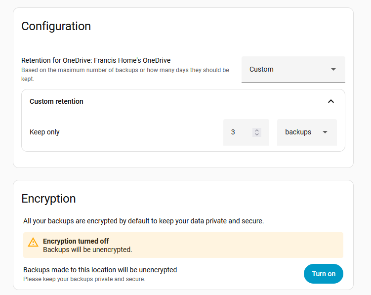

I like this new automatic backup to server feature, devs, though I wish you could disable the encryption. Honestly, I feel like if a hacker is good enough to get in, they can probably find the emergency backup file anyway.
