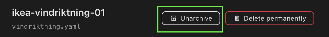

The dashboard “Delete” action has moved configs to an archive folder for a long time; the new Device Builder (default in the add-on since ESPHome 2026.6.0) even has an “Archived devices” menu with an Unarchive button. Something I didn’t know until after I did all this. From the shell:
ls -la /config/esphome/archive/
If nothing obvious is there, search the whole ESPHome tree, including any surviving build directories, for the device name or the sensor name:
grep -rIl -E 'air-sensor-01|Particulate Matter 2.5' /config/esphome /data 2>/dev/null
Mine was sitting right there:
/config/esphome/archive/vindriktning.yaml
Moving it back up a level makes it reappear in the dashboard, though the best way is probably to use the UI and the unarchive option:
mv /config/esphome/archive/vindriktning.yaml /config/esphome/
