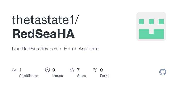

I don’t think it’s quite that simple. I gathered the online specs on my brief start at this topic (before I disassembled the tank that had ReefLED lights on it): GitHub - brettonw/RSLED: Home Assistant integration for controlling Red Sea RSLED lights. - the readme has the images and ratios for the different light specs.

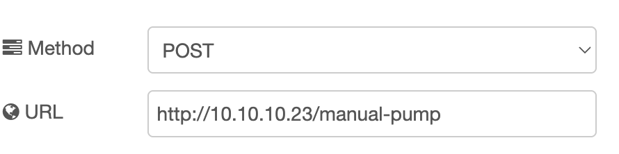

For ATO:
  • POST to /manual-pump and /stop to toggle the pump.
  • PUT to /configuration with {“auto_fill”: true} or {“auto_fill”: false} to toggle the auto filling when the sensor is low - That’s a going to be really handy for me.

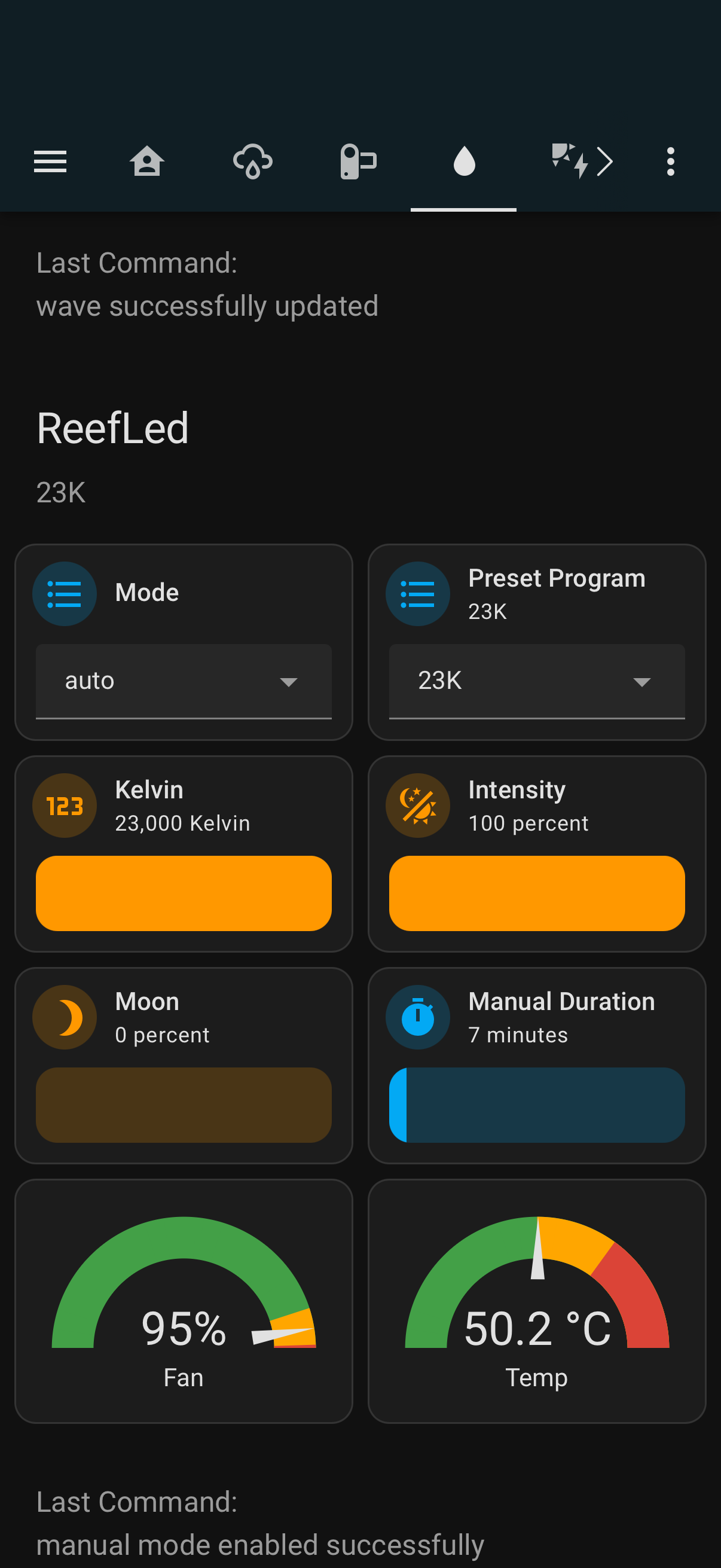

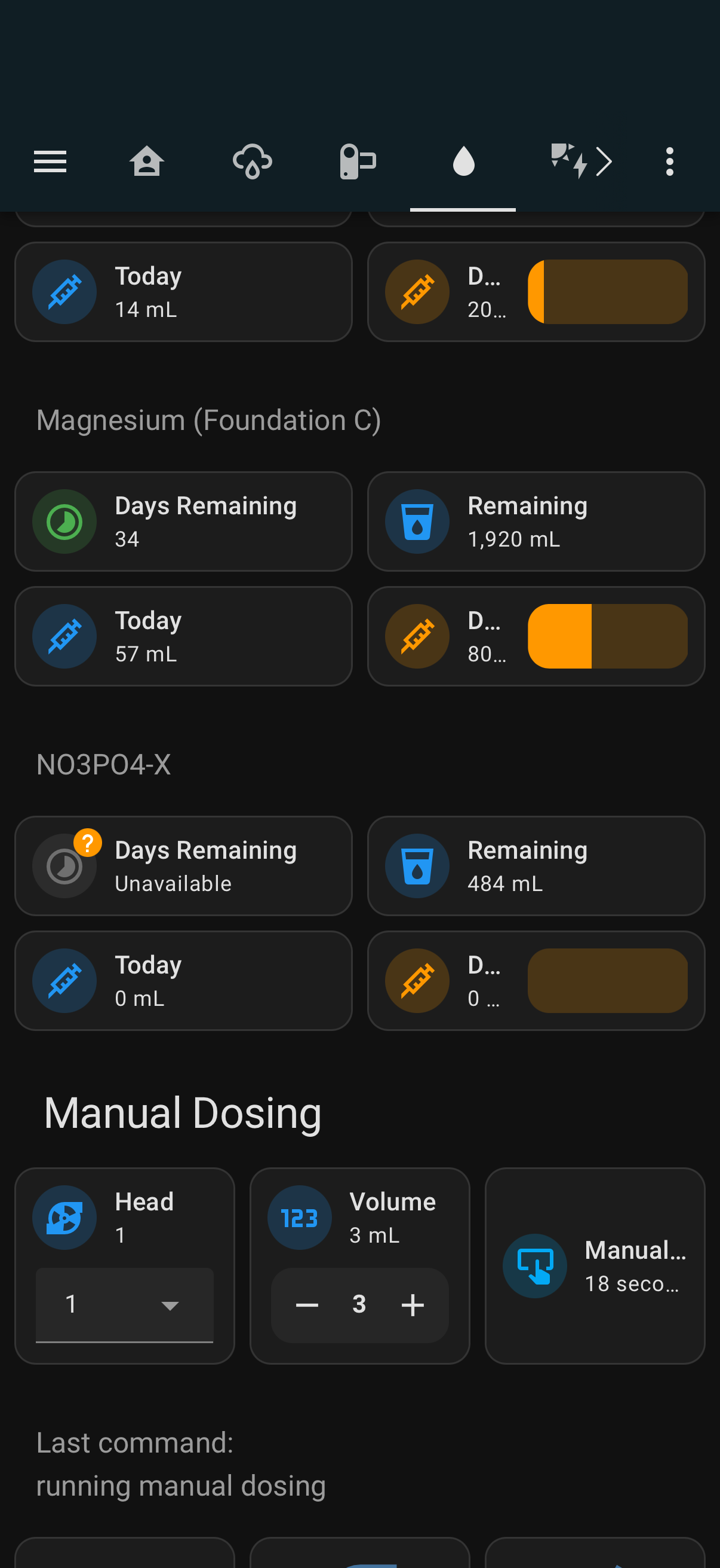

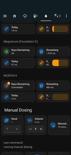

I’ve updated the node-red integration to include:
ReefDose:
  • manual dosing is now supported. An example use case is to dose coral food (e.g. AB+) manually when you like or to automate it with a feed mode in HA. Select the head, enter volume, press dose.
ReefLed:
  • Tested with G2 60
  • Expose sensors
  • Manual control. When in manual mode you can adjust kelvin, intensity, moon, duration. Blue and white seem to be calculated from kelvin and intensity so not updating them.
  • Mode: auto, manual, off. Auto turns on the default preset program
  • Haven’t tested with multiple lights. Not sure if the RedSea ones act as a group like Radions or if each need to be controlled separately.
  • Found cloud endpoints for setting the Preset programs. Haven’t found the equivalent local endpoints but will persevere.
Added a place holder for ATO to get sensor values but need one to test.
Additional endpoints discovered are in the node-red flow comment nodes.

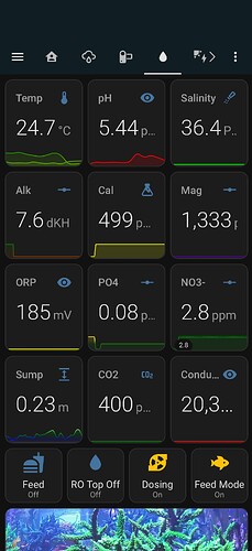

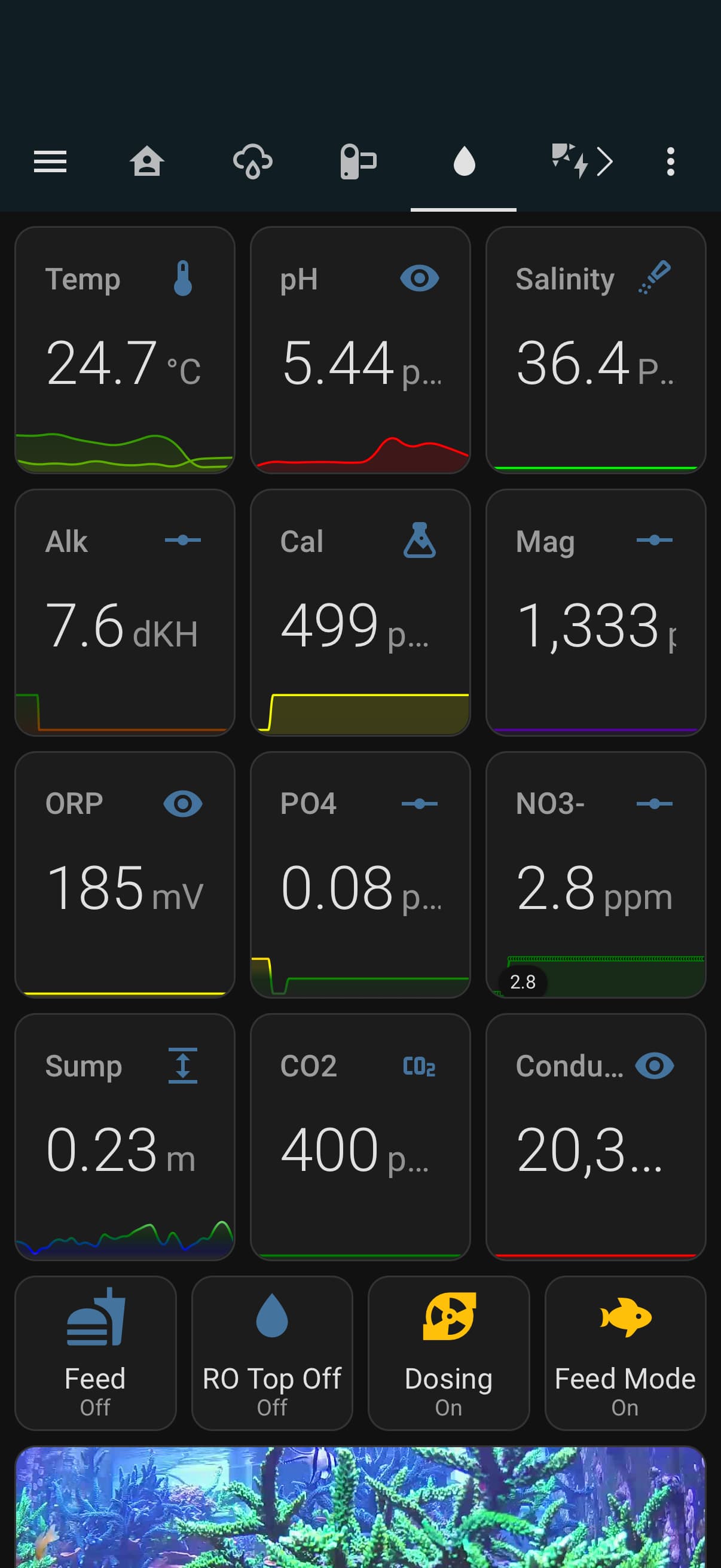

Some example mushroom cards:

I can’t access your GitHub repository link. Three are publicly available.

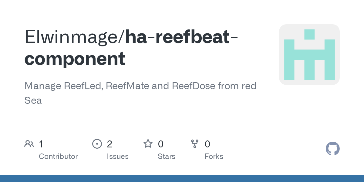

I m working on a new integration to support reefled, reefmat and reefdose it will be the perfect place.
If someone have reefwave, reef dc skimmer, reefato+ and/or reefrun i ll try to integrate them too.

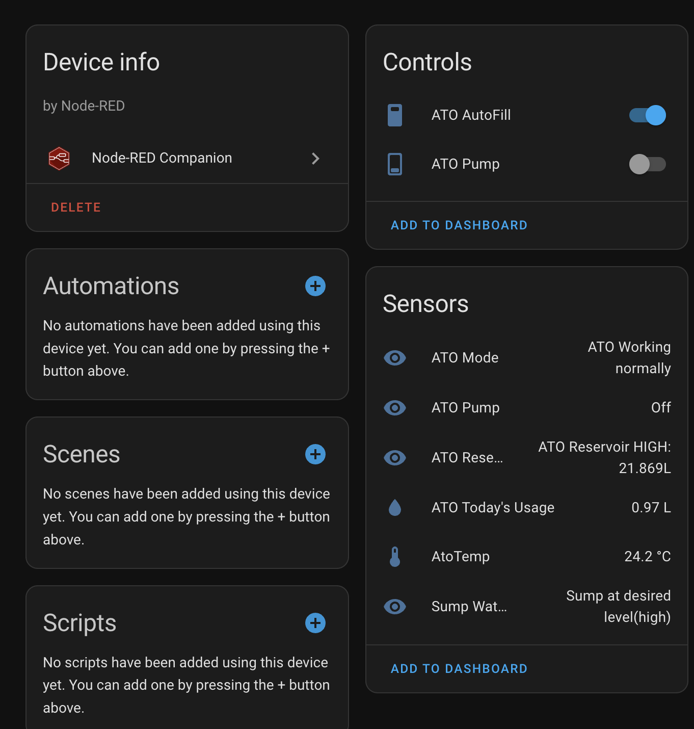

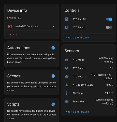

Here’s my flow from node-red.
FYI: The function nodes shows the other valid states for the entities I want to track as well as some quality-of-life stuff, such as rounding to sensible precision and converting to human readable text.
ATO:
[{"id":"b77b0a35880f0b1c","type":"http request","z":"8f06660af350a487","name":"","method":"GET","ret":"obj","paytoqs":"ignore","url":"http://10.10.10.23/dashboard","tls":"","persist":false,"proxy":"","insecureHTTPParser":false,"authType":"","senderr":false,"headers":[],"x":370,"y":3120,"wires":[["5e3a153ab8650466","18149ce8f61a52c5","7f369684f39354a1","879fca8f03c5f3b9","b85f5af129d9d65b"]]},{"id":"19cc21ed9c6452f8","type":"ha-sensor","z":"8f06660af350a487","name":"ato_water_level","entityConfig":"e0cc14607f8ffb8b","version":0,"state":"payload.water_level","stateType":"msg","attributes":[],"inputOverride":"allow","outputProperties":[],"x":740,"y":3120,"wires":[[]]},{"id":"76b5ef641d7a427b","type":"ha-sensor","z":"8f06660af350a487","name":"ato_today_used","entityConfig":"ea7abf85b7b0c995","version":0,"state":"payload.corrected_volume_usage","stateType":"msg","attributes":[],"inputOverride":"allow","outputProperties":[],"x":580,"y":3180,"wires":[[]]},{"id":"5e3a153ab8650466","type":"ha-sensor","z":"8f06660af350a487","name":"ato_pump","entityConfig":"163b7e49680eacc0","version":0,"state":"payload.pump_state","stateType":"msg","attributes":[],"inputOverride":"allow","outputProperties":[],"x":560,"y":3080,"wires":[[]]},{"id":"16c7a93013ac46eb","type":"ha-sensor","z":"8f06660af350a487","name":"ato_temperature","entityConfig":"b3aea473176252db","version":0,"state":"payload.ato_sensor.current_read","stateType":"msg","attributes":[{"property":"ato_tmp","value":"","valueType":"num"}],"inputOverride":"allow","outputProperties":[],"x":580,"y":3220,"wires":[[]]},{"id":"18149ce8f61a52c5","type":"function","z":"8f06660af350a487","name":"format","func":"msg.payload.ato_sensor.current_read = Number(msg.payload.ato_sensor.current_read).toFixed(1);\nreturn msg;\n","outputs":1,"timeout":0,"noerr":0,"initialize":"","finalize":"","libs":[],"x":370,"y":3220,"wires":[["16c7a93013ac46eb"]]},{"id":"2a09679cacedaf1d","type":"inject","z":"8f06660af350a487","name":"Every 5 Minutes","props":[{"p":"payload"},{"p":"topic","vt":"str"}],"repeat":"300","crontab":"","once":true,"onceDelay":"45","topic":"","payload":"","payloadType":"date","x":150,"y":3140,"wires":[["b77b0a35880f0b1c"]]},{"id":"d8f4f28fa558ae51","type":"ha-sensor","z":"8f06660af350a487","name":"rs_ato_mode","entityConfig":"d37f7405beee8e84","version":0,"state":"payload.mode","stateType":"msg","attributes":[],"inputOverride":"allow","outputProperties":[],"x":730,"y":3040,"wires":[[]]},{"id":"b82c3efe799ae64e","type":"comment","z":"8f06660af350a487","name":"ATO","info":"","x":130,"y":3020,"wires":[]},{"id":"95a1b5f07c998f6f","type":"link in","z":"8f06660af350a487","name":"Inject ATO","links":["9921dd9ef6116be6","15f1744f0e1b44ab","813d889eec545492"],"x":225,"y":3100,"wires":[["b77b0a35880f0b1c"]]},{"id":"8ab91246d2a93f7a","type":"ha-switch","z":"8f06660af350a487","name":"ATO Pump","version":0,"debugenabled":false,"inputs":0,"outputs":2,"entityConfig":"617002a45758e6c2","enableInput":false,"outputOnStateChange":true,"outputProperties":[{"property":"outputType","propertyType":"msg","value":"state change","valueType":"str"},{"property":"payload","propertyType":"msg","value":"","valueType":"entityState"}],"x":140,"y":3460,"wires":[["8ab6f618a76993cb"],["8ab6f618a76993cb"]]},{"id":"52afb7365a0ac61d","type":"http request","z":"8f06660af350a487","name":"","method":"POST","ret":"obj","paytoqs":"ignore","url":"http://10.10.10.23/manual-pump","tls":"","persist":false,"proxy":"","insecureHTTPParser":false,"authType":"","senderr":false,"headers":[],"x":410,"y":3440,"wires":[["440d6d83614441a4","84b4cdcb5b49ca74","680ff1dca067249e","a7bd45dda994682b"]]},{"id":"644e914d1643e784","type":"http request","z":"8f06660af350a487","name":"","method":"POST","ret":"obj","paytoqs":"ignore","url":"http://10.10.10.23/stop","tls":"","persist":false,"proxy":"","insecureHTTPParser":false,"authType":"","senderr":false,"headers":[],"x":410,"y":3540,"wires":[["1a666ad5d772d8f2","8ec88edd3e5d0110"]]},{"id":"dd6dc6e17a9d893b","type":"ha-switch","z":"8f06660af350a487","name":"ATO AutoFill","version":0,"debugenabled":false,"inputs":0,"outputs":2,"entityConfig":"e5f789072f393123","enableInput":false,"outputOnStateChange":true,"outputProperties":[{"property":"outputType","propertyType":"msg","value":"state change","valueType":"str"},{"property":"payload","propertyType":"msg","value":"","valueType":"entityState"}],"x":150,"y":3320,"wires":[["cf7f2fde58c681ef"],["059bbf7e84ccec28"]]},{"id":"cf7f2fde58c681ef","type":"change","z":"8f06660af350a487","name":"AutoFill On","rules":[{"t":"set","p":"payload","pt":"msg","to":"{\"auto_fill\":  true}","tot":"json"}],"action":"","property":"","from":"","to":"","reg":false,"x":350,"y":3300,"wires":[["6f3e02495ba14348"]]},{"id":"059bbf7e84ccec28","type":"change","z":"8f06660af350a487","name":"AutoFill Off","rules":[{"t":"set","p":"payload","pt":"msg","to":"{\"auto_fill\":  false}","tot":"json"}],"action":"","property":"","from":"","to":"","reg":false,"x":350,"y":3340,"wires":[["6f3e02495ba14348"]]},{"id":"6f3e02495ba14348","type":"http request","z":"8f06660af350a487","name":"","method":"PUT","ret":"obj","paytoqs":"ignore","url":"http://10.10.10.23/configuration","tls":"","persist":false,"proxy":"","insecureHTTPParser":false,"authType":"","senderr":false,"headers":[],"x":530,"y":3320,"wires":[[]]},{"id":"15f1744f0e1b44ab","type":"link out","z":"8f06660af350a487","name":"Inject ATO","mode":"link","links":["95a1b5f07c998f6f"],"x":695,"y":3580,"wires":[]},{"id":"1a666ad5d772d8f2","type":"delay","z":"8f06660af350a487","name":"","pauseType":"delay","timeout":"5","timeoutUnits":"seconds","rate":"1","nbRateUnits":"1","rateUnits":"second","randomFirst":"1","randomLast":"5","randomUnits":"seconds","drop":false,"allowrate":false,"outputs":1,"x":580,"y":3580,"wires":[["15f1744f0e1b44ab"]]},{"id":"7f369684f39354a1","type":"function","z":"8f06660af350a487","name":"format","func":"msg.payload.corrected_volume_usage = msg.payload.today_volume_usage / 1000;\n\nreturn msg;","outputs":1,"timeout":0,"noerr":0,"initialize":"","finalize":"","libs":[],"x":370,"y":3180,"wires":[["76b5ef641d7a427b"]]},{"id":"440d6d83614441a4","type":"api-call-service","z":"8f06660af350a487","name":"Notify","server":"666aa37e1d30361f","version":7,"debugenabled":false,"action":"notify.mobile_app_iphone","floorId":[],"areaId":[],"deviceId":[],"entityId":[],"labelId":[],"data":"{\"message\":\"ATO ON.\",\"title\":\"TANK ALERT\"}","dataType":"jsonata","mergeContext":"","mustacheAltTags":false,"outputProperties":[],"queue":"none","blockInputOverrides":true,"domain":"notify","service":"mobile_app_iphone","x":570,"y":3400,"wires":[[]]},{"id":"84b4cdcb5b49ca74","type":"alexa-remote-routine","z":"8f06660af350a487","name":"ALERT","account":"5c36519b4998d824","routineNode":{"type":"speakAtVolume","payload":{"type":"announcement","text":{"type":"str","value":"WARNING: A T O  PUMP ACTIVATED "},"volume":{"type":"num","value":"20"},"mode":"set","devices":["1467efeaa741422bbee0d6f0d4b0515d"]}},"x":690,"y":3400,"wires":[[]]},{"id":"8ab6f618a76993cb","type":"switch","z":"8f06660af350a487","name":"","property":"payload","propertyType":"msg","rules":[{"t":"true"},{"t":"false"}],"checkall":"true","repair":false,"outputs":2,"x":270,"y":3460,"wires":[["52afb7365a0ac61d"],["644e914d1643e784"]]},{"id":"1eb58491bdc3eb9e","type":"delay","z":"8f06660af350a487","name":"","pauseType":"delay","timeout":"5","timeoutUnits":"seconds","rate":"1","nbRateUnits":"1","rateUnits":"second","randomFirst":"1","randomLast":"5","randomUnits":"seconds","drop":false,"allowrate":false,"outputs":1,"x":760,"y":3440,"wires":[["813d889eec545492"]]},{"id":"813d889eec545492","type":"link out","z":"8f06660af350a487","name":"Inject ATO","mode":"link","links":["95a1b5f07c998f6f"],"x":865,"y":3440,"wires":[]},{"id":"a7bd45dda994682b","type":"delay","z":"8f06660af350a487","name":"","pauseType":"delay","timeout":"5","timeoutUnits":"minutes","rate":"1","nbRateUnits":"1","rateUnits":"second","randomFirst":"1","randomLast":"5","randomUnits":"seconds","drop":false,"allowrate":false,"outputs":1,"x":580,"y":3480,"wires":[["29666577316e52e1"]]},{"id":"29666577316e52e1","type":"api-call-service","z":"8f06660af350a487","name":"","server":"666aa37e1d30361f","version":7,"debugenabled":false,"action":"switch.turn_off","floorId":[],"areaId":[],"deviceId":[],"entityId":["switch.ato_pump"],"labelId":[],"data":"","dataType":"jsonata","mergeContext":"","mustacheAltTags":false,"outputProperties":[],"queue":"none","blockInputOverrides":true,"domain":"switch","service":"turn_off","x":760,"y":3480,"wires":[[]]},{"id":"8ec88edd3e5d0110","type":"delay","z":"8f06660af350a487","name":"","pauseType":"delay","timeout":"15","timeoutUnits":"seconds","rate":"1","nbRateUnits":"1","rateUnits":"second","randomFirst":"1","randomLast":"5","randomUnits":"seconds","drop":false,"allowrate":false,"outputs":1,"x":580,"y":3540,"wires":[["b243e78b1b0dbcfa"]]},{"id":"087c4751f47f7cc0","type":"alexa-remote-routine","z":"8f06660af350a487","name":"ALERT","account":"5c36519b4998d824","routineNode":{"type":"speakAtVolume","payload":{"type":"announcement","text":{"type":"msg","value":"payload.message"},"volume":{"type":"num","value":"50"},"mode":"set","devices":["1467efeaa741422bbee0d6f0d4b0515d"]}},"x":1150,"y":3540,"wires":[[]]},{"id":"879fca8f03c5f3b9","type":"function","z":"8f06660af350a487","name":"format","func":"let message;\n\nif (msg.payload.water_level === 'desired_level_1') {\n    message = 'Sump at desired level(low)';\n} else if (msg.payload.water_level === 'desired_level_2') {\n    message = 'Sump at desired level(high)';\n} else if (msg.payload.water_level === 'below') {\n    message = 'Caution: Sump BELOW desired level';\n} else if (msg.payload.water_level === 'high') {\n    message = 'Caution: Sump ABOVE desired level';\n} else {\n    message = 'Caution: Sump level unknown';\n}\n\n// Set the payload message\nmsg.payload.water_level = message;\n\nreturn msg;","outputs":1,"timeout":0,"noerr":0,"initialize":"","finalize":"","libs":[],"x":550,"y":3120,"wires":[["19cc21ed9c6452f8"]]},{"id":"b85f5af129d9d65b","type":"function","z":"8f06660af350a487","name":"format","func":"let message;\n\nif (msg.payload.mode === 'auto') {\n    message = 'ATO Working normally';\n} else if (msg.payload.water_level === 'empty') {\n    message = 'ATO Resevoir Empty';\n\n} else {\n    message = 'Caution: ATO Status Unknown';\n}\n\n// Set the payload message\nmsg.payload.mode = message;\n\nreturn msg;","outputs":1,"timeout":0,"noerr":0,"initialize":"","finalize":"","libs":[],"x":550,"y":3040,"wires":[["d8f4f28fa558ae51"]]},{"id":"680ff1dca067249e","type":"api-current-state","z":"8f06660af350a487","name":"Get Initial Usage","server":"666aa37e1d30361f","version":3,"outputs":1,"halt_if":"","halt_if_type":"str","halt_if_compare":"is","entity_id":"sensor.ato_today_s_usage","state_type":"str","blockInputOverrides":false,"outputProperties":[{"property":"payload","propertyType":"msg","value":"","valueType":"entityState"},{"property":"data","propertyType":"msg","value":"","valueType":"entity"},{"property":"ato_initial_usage","propertyType":"flow","value":"","valueType":"entityState"}],"for":0,"forType":"num","forUnits":"minutes","x":600,"y":3440,"wires":[["1eb58491bdc3eb9e"]]},{"id":"b243e78b1b0dbcfa","type":"api-current-state","z":"8f06660af350a487","name":"Get Final Usage","server":"666aa37e1d30361f","version":3,"outputs":1,"halt_if":"","halt_if_type":"str","halt_if_compare":"is","entity_id":"sensor.ato_today_s_usage","state_type":"str","blockInputOverrides":false,"outputProperties":[{"property":"payload","propertyType":"msg","value":"","valueType":"entityState"},{"property":"data","propertyType":"msg","value":"","valueType":"entity"},{"property":"ato_final_usage","propertyType":"flow","value":"","valueType":"entityState"}],"for":0,"forType":"num","forUnits":"minutes","x":760,"y":3540,"wires":[["c3b1b09e9441f8e3"]]},{"id":"c3b1b09e9441f8e3","type":"function","z":"8f06660af350a487","name":"Calculate Volume","func":"// Get stored usage values\nconst initialUsage = parseFloat(flow.get('ato_initial_usage') || 0);\nconst finalUsage = parseFloat(flow.get('ato_final_usage') || 0);\n\nconst volumeUsed = finalUsage - initialUsage;\n\n// Format message based on volume\nlet message;\nif (volumeUsed >= 1) {\n    message = `ATO used ${volumeUsed.toFixed(2)} liters`;\n} else if (volumeUsed > 0) {\n    const volumeInMl = volumeUsed * 1000;\n    message = `ATO used ${volumeInMl.toFixed(0)} ml`;\n} else {\n    message = `ATO used 0 ml (no water detected)`;\n}\n\n// Create notification payload\nmsg.payload = {\n    message: message,\n    title: \"ATO Volume Report\"\n};\n\nreturn msg;","outputs":1,"timeout":"","noerr":0,"initialize":"","finalize":"","libs":[],"x":960,"y":3540,"wires":[["087c4751f47f7cc0"]]},{"id":"e0cc14607f8ffb8b","type":"ha-entity-config","server":"666aa37e1d30361f","deviceConfig":"527396ce84a3e9d3","name":"rs_ato_water_level","version":"6","entityType":"sensor","haConfig":[{"property":"name","value":"Sump Water Level"},{"property":"icon","value":""},{"property":"entity_picture","value":""},{"property":"entity_category","value":""},{"property":"device_class","value":""},{"property":"unit_of_measurement","value":""},{"property":"state_class","value":""}],"resend":false,"debugEnabled":false},{"id":"ea7abf85b7b0c995","type":"ha-entity-config","server":"666aa37e1d30361f","deviceConfig":"527396ce84a3e9d3","name":"rs_ato_today","version":"6","entityType":"sensor","haConfig":[{"property":"name","value":"ATO Today's Usage"},{"property":"icon","value":""},{"property":"entity_picture","value":""},{"property":"entity_category","value":""},{"property":"device_class","value":"water"},{"property":"unit_of_measurement","value":"L"},{"property":"state_class","value":""}],"resend":true,"debugEnabled":false},{"id":"163b7e49680eacc0","type":"ha-entity-config","server":"666aa37e1d30361f","deviceConfig":"527396ce84a3e9d3","name":"rs_ato_pump","version":"6","entityType":"sensor","haConfig":[{"property":"name","value":"ATO Pump"},{"property":"icon","value":""},{"property":"entity_picture","value":""},{"property":"entity_category","value":""},{"property":"device_class","value":""},{"property":"unit_of_measurement","value":""},{"property":"state_class","value":""}],"resend":false,"debugEnabled":false},{"id":"b3aea473176252db","type":"ha-entity-config","server":"666aa37e1d30361f","deviceConfig":"527396ce84a3e9d3","name":"Internal Sump Temp","version":6,"entityType":"sensor","haConfig":[{"property":"name","value":"AtoTemp"},{"property":"icon","value":""},{"property":"entity_picture","value":""},{"property":"entity_category","value":""},{"property":"device_class","value":"temperature"},{"property":"unit_of_measurement","value":"°C"},{"property":"state_class","value":""}],"resend":false,"debugEnabled":false},{"id":"d37f7405beee8e84","type":"ha-entity-config","server":"666aa37e1d30361f","deviceConfig":"527396ce84a3e9d3","name":"rs_ato_mode","version":6,"entityType":"sensor","haConfig":[{"property":"name","value":"ATO Mode"},{"property":"icon","value":""},{"property":"entity_picture","value":""},{"property":"entity_category","value":""},{"property":"device_class","value":""},{"property":"unit_of_measurement","value":""},{"property":"state_class","value":""}],"resend":true,"debugEnabled":false},{"id":"617002a45758e6c2","type":"ha-entity-config","server":"666aa37e1d30361f","deviceConfig":"527396ce84a3e9d3","name":"ato_pump","version":6,"entityType":"switch","haConfig":[{"property":"name","value":"ATO Pump"},{"property":"icon","value":""},{"property":"entity_picture","value":""},{"property":"entity_category","value":""},{"property":"device_class","value":""}],"resend":false,"debugEnabled":false},{"id":"e5f789072f393123","type":"ha-entity-config","server":"666aa37e1d30361f","deviceConfig":"527396ce84a3e9d3","name":"ato_autofill","version":6,"entityType":"switch","haConfig":[{"property":"name","value":"ATO AutoFill"},{"property":"icon","value":""},{"property":"entity_picture","value":""},{"property":"entity_category","value":""},{"property":"device_class","value":""}],"resend":false,"debugEnabled":false},{"id":"666aa37e1d30361f","type":"server","name":"Home Assistant","version":5,"addon":true,"rejectUnauthorizedCerts":true,"ha_boolean":"y|yes|true|on|home|open","connectionDelay":true,"cacheJson":true,"heartbeat":true,"heartbeatInterval":"30","areaSelector":"id","deviceSelector":"id","entitySelector":"id","statusSeparator":": ","statusYear":"hidden","statusMonth":"short","statusDay":"numeric","statusHourCycle":"default","statusTimeFormat":"h:m","enableGlobalContextStore":true},{"id":"5c36519b4998d824","type":"alexa-remote-account","name":"Alexa","authMethod":"proxy","proxyOwnIp":"10.10.10.50","proxyPort":"3456","cookieFile":"alexa","refreshInterval":"3","alexaServiceHost":"alexa.amazon.com.au","pushDispatchHost":"","amazonPage":"amazon.com.au","acceptLanguage":"en-US","onKeywordInLanguage":"on","userAgent":"","usePushConnection":"on","autoInit":"on"},{"id":"527396ce84a3e9d3","type":"ha-device-config","name":"ReefATO","hwVersion":"","manufacturer":"Node-RED","model":"","swVersion":""}]

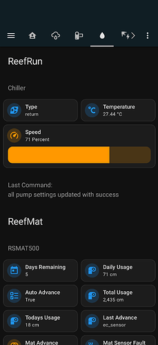

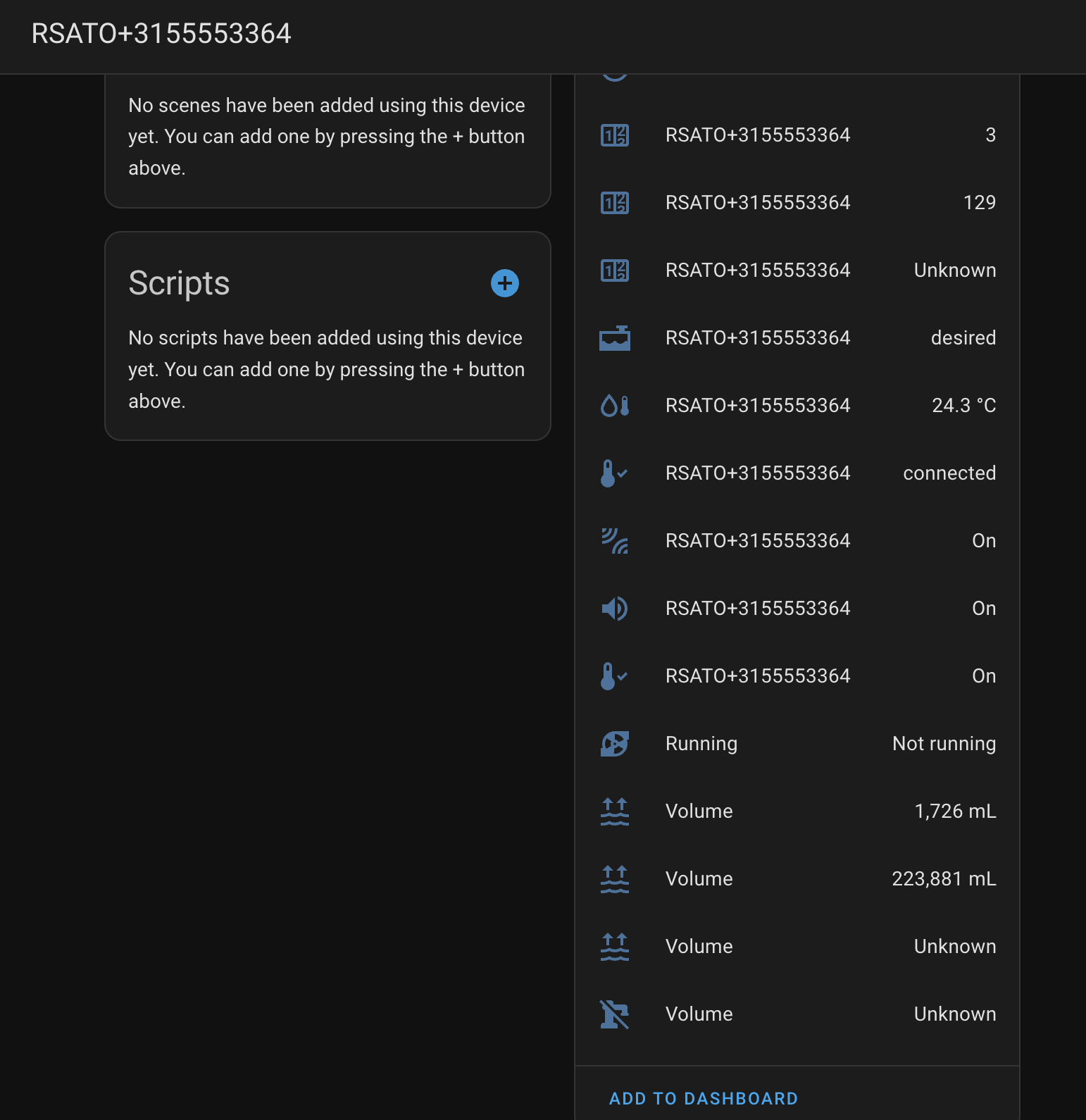

I just published v0.4.0 that natively support (no need for rednode):
  • ReefLed
  • ReefMat
  • ReefDose (Partialy work in progress)
  • and ReefATO+
Because I have no ReefATO+ I can not validate the implementation. @rkarolek is helping but other volunteer will help validating.
If someone have reefwave, reef dc skimmer and/or reefrun I ll try to integrate them too.
If you need other sensors or actuators in ReefLed, ReefMat, ReefDose or ReefATO+ let me know.

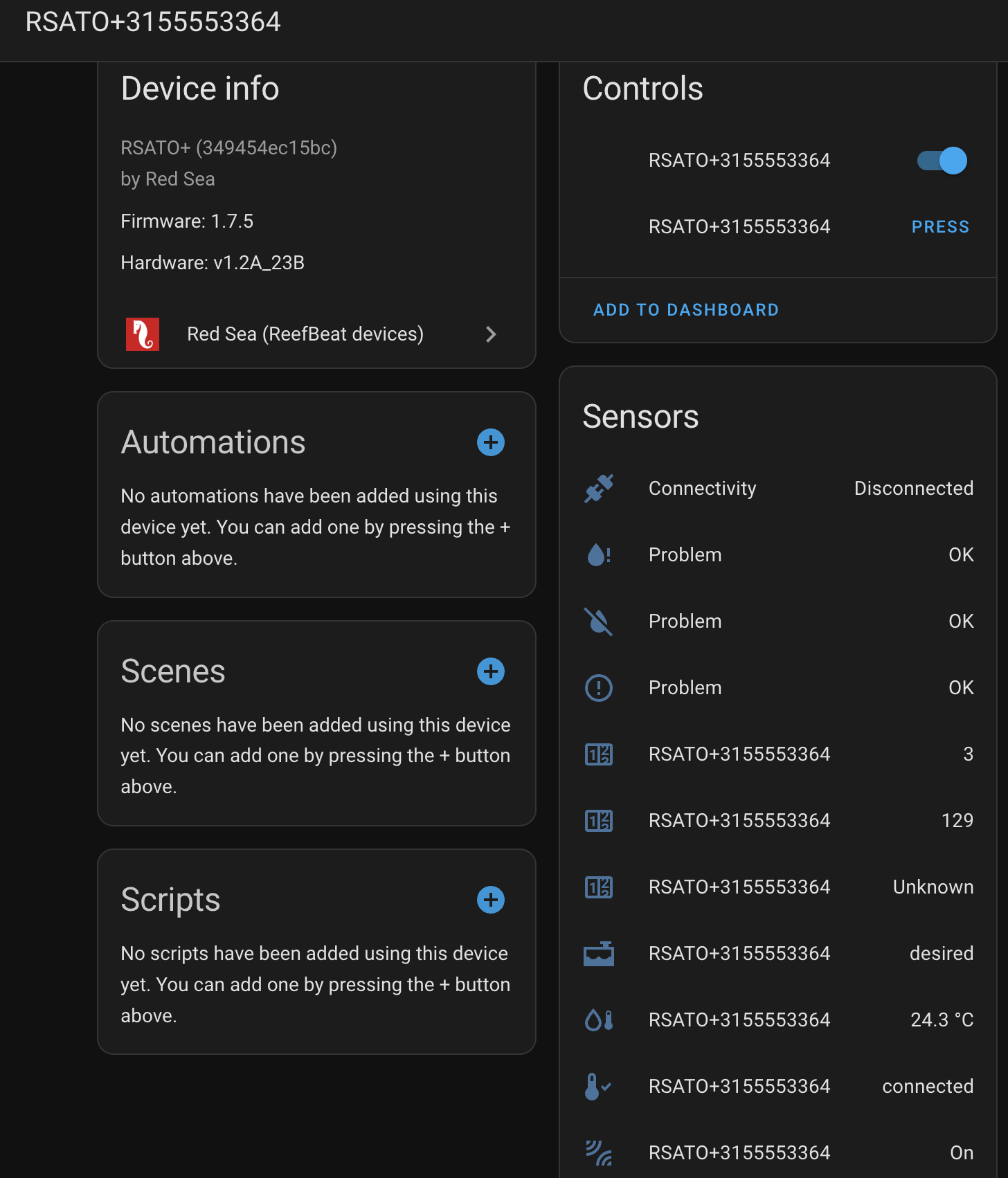

I tried your integration and am unable to validate the ATO side. Reports as disconnected though it does discover the correct IP.
I understand you’re making a local integration, though if you import my flow, you should get confirmation of the correct syntax as well as tips on decluttering/making human readable without resorting to external cards.:+1:
I use node-red to get all the different brands communicating for automation and then output to HA
I’m happy with how mine is setup but it’s certainly not ‘simple’. Happy to try and contribute to your integration if it helps …
Can you send me the error messages on the logs ?
When you say disconnected you mean senors are availables but no data are set?
Sorry mate - cache issue and conflicting entities - my bad.
Yeah, your integration works but the manual pump doesn’t - assuming thats the button.
