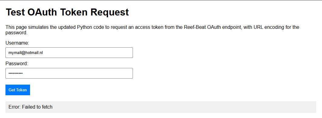

I have put this into a simple html page since I have not a working python tester over here.
and console; Screenshot by Lightshot
Could it be a setting inside ReefBeat?
Sorry the image do not display.

The error, which is coming back in the html page is: “Error: Failed to fetch”, inside the console is says the same.
I tried to login into the ReefBeat app again to make sure the username (mailadres) and password are correct. So I have no idea why it is not working
Try to chane your password with only alphanumeric characters ( without any special characters ).

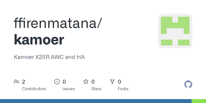

Also for those interested, I've done similar work on Kamoer devices.
It relies on a MITM attack to redirect the device to your own MQTT server, allowing full local control in HA.
It's possible to turn this work into a formal HA integration, but that will require a bit of work - maybe a project for another day!
Kamoer X2SR AWC and HA
