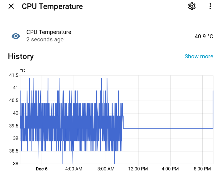

Thank you for your reply. I mean I see in the history that the sensor has been recorded many times a minute. I have an automation that warns me if temperature is above a certain temp which will give me a warning, so I want it to be active whenever it changes. I just want to minimize the history that is written to the logs.
Please share a screenshot of this. As I said the default is 60 seconds.
I trust you, i thought it logged everytime the temperature changed. This is a screenshot, but I excluded it from recorder today and it seems like it’s just a line now more or less.
If you exclude it from the recorder then you have no saved history to plot.
I think it work as I want it now :slight_smile: Thank you very much!
