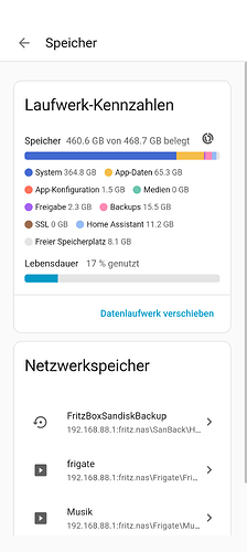

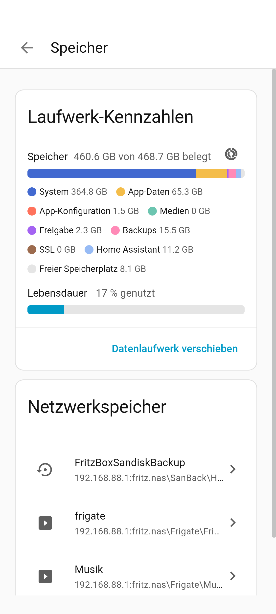

Reduce systemsize
I realized, that systemsize is 360Gb!
How can I reduce this?
Best regards,
Stefan
You can try to figure out what those DATAs are, seems like you have a huge installation, with tons of app-data 65.3 / backups 15.3 , /config 11.2 sounds also HUGE
How about your DB ?
Then you might have to look into “Docker” also , And /var/log/journal
Hi Stefan.
Click on that little symbol to the right of the word ‘belegt’ in your first picture you posted. Find it interesting?
