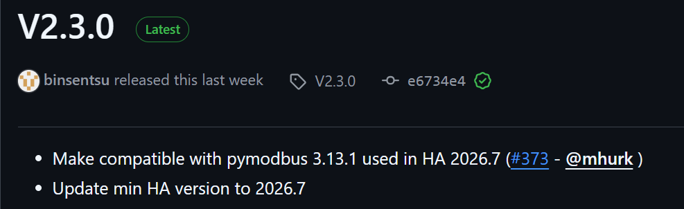

I’m assuming you’re referring to the Solaredge Modbus custom integration. If so, did you read the release notes for the latest release?
It’s also mentioned in one of the closed issues on github here.
All you have to do is follow these simple steps:
  • Update HA Core to 2026.7 & wait until HA restarts. At this point Solaredge will stop working.
  • Update Solaredge to 2.3.0 & restart HA. It should now be working again
  • (In case of emergency) Take note of the Solaredge logs. Restore your backups. Report the issue on the Solaredge Modbus github.
