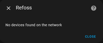

I have two Refoss EM06 devices. Their IPs are 192.168.4.11 and 192.168.4.12.
My Home Assistant runs on a VM on a Machine on 192.168.122.222. When I start the Refoss setup, I get this result:
(The networks can see each other)
How do I instruct the Refoss integration to search another network or enter the IP manually?
