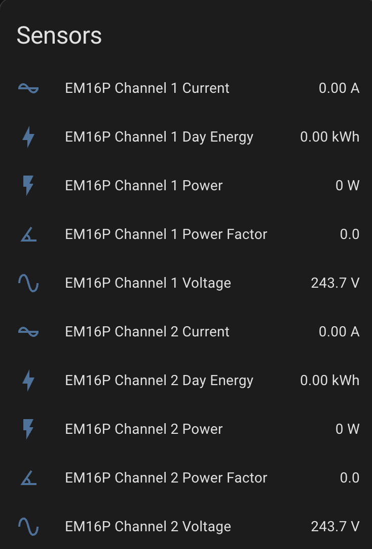

Hi. I just got one of these in Australia from Amazon, branded as Meross rather than Refoss, but I think it’s the same thing. Seems to work OK, but struggled to get the integration working in HA. Instead I used MQTT. From the devices own webpage I set up all my mqtt details, and i could see it posting MQTT updates, however it doesn’t do HA Autodiscovery, so I created this automation to make the correct autodiscovery entries…

Of course you’ll need to change the device IDs at the top of the automation to match your own, but other than that it should work as-is.
