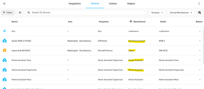

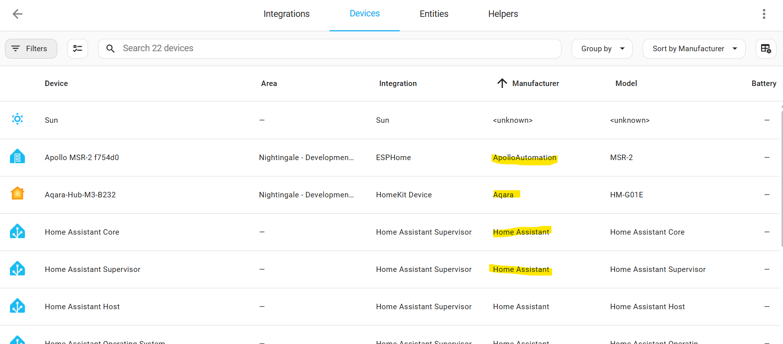

Hi again I need some help I want to get the integration information when I passed the device id but I get None as the response can you help me I was able to get manufacturere and model device_attr(‘c2936c503fed4d745798ad6ecc19xxxx’, ‘integration’)
That information isn’t stored as a device property, and isn’t in the list I linked.
Looks like you might be able to get it via the domain attribute of the poorly-documented config entry for each entity [ref]:
{{ config_entry_attr(config_entry_id('sensor.aquarium_temperature'),'domain') }}
# returns 'esphome', as that entity is an ESPHome device entity
…and if you already know the integration name [ref]:
{{ integration_entities('esphome') }}
# for me, returns a big list including the aquarium sensor above
The integration name is all lowercase, as shown on the integration’s HA screen URL.
Still think you’re probably going about this the wrong way, but unless you properly describe what you’re trying to do, it’s hard to help further.
