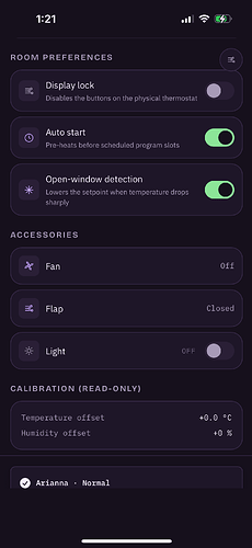

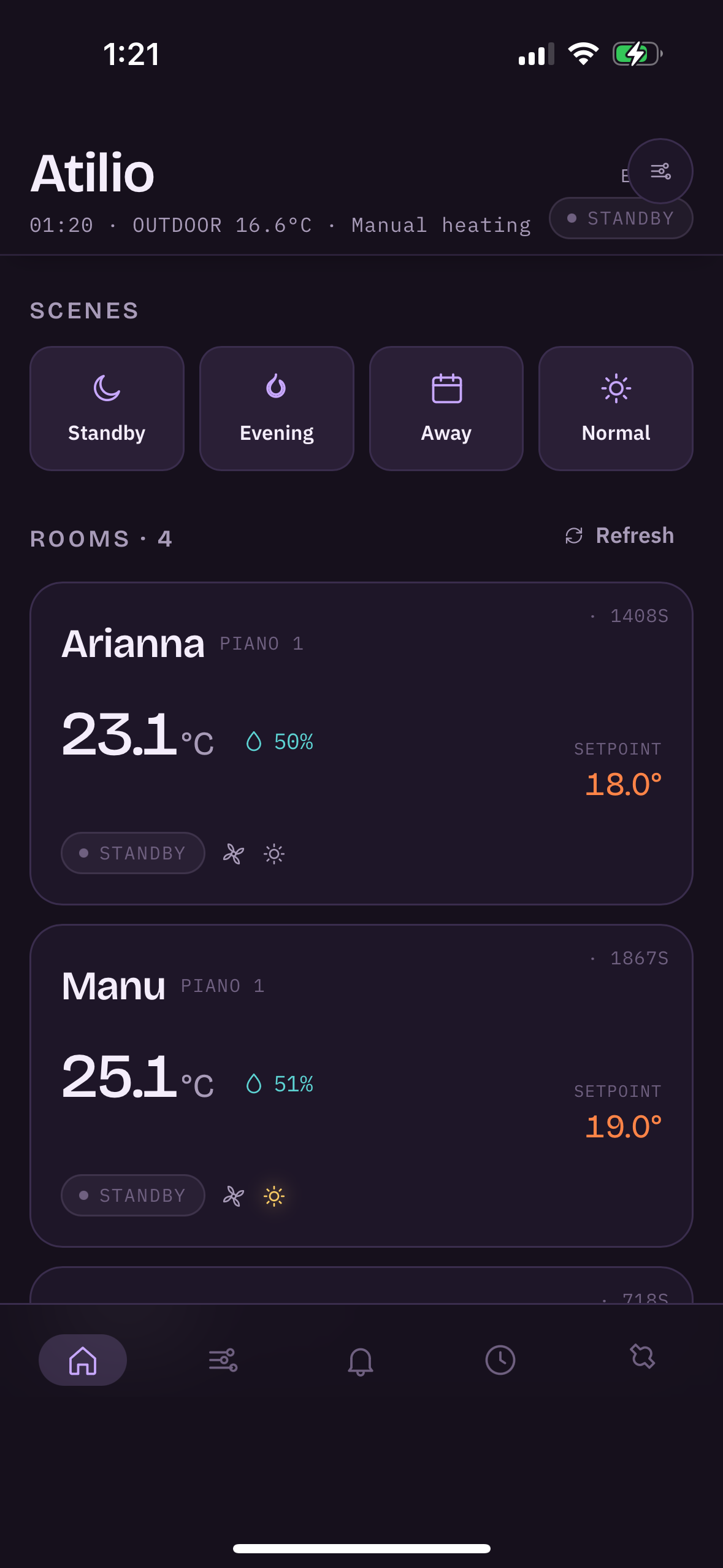

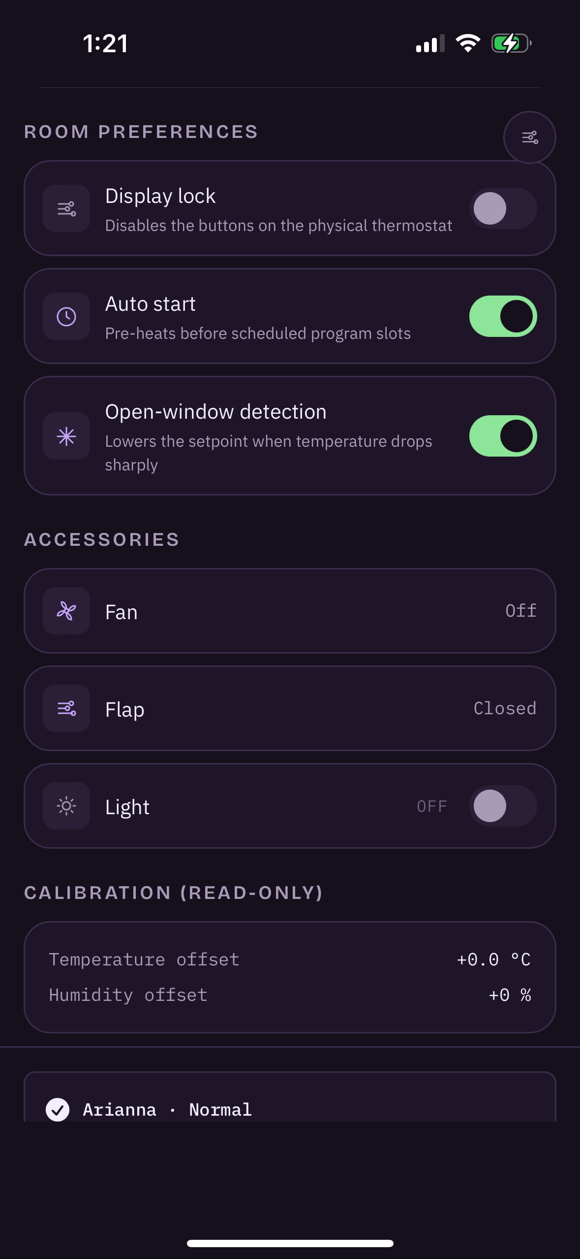

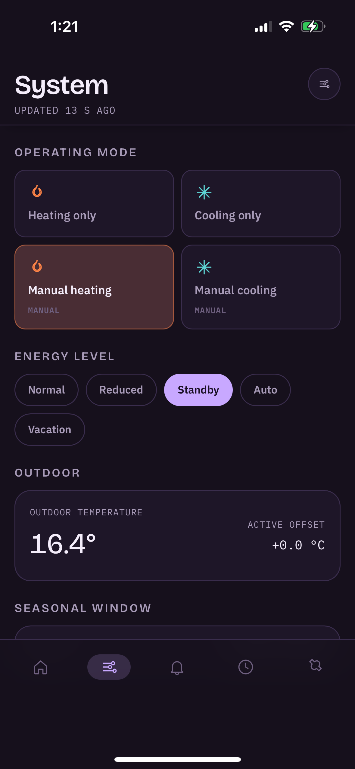

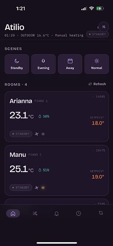

What v6 gives you
  • One HA device per REHAU installation, all auto-discovered via MQTT
  • climate.* per room with the right mode mapping (off/heat/auto + REHAU's native presets)
  • Per-room switches: lock / auto-start / open-window detection
  • Per-room fancoil running binary_sensor with the actual motor state (mirrors REHAU's pink fan icon)
  • Diagnostic sensors for the full bus I/O (RZ, RELAY, DI, AI, AO) on master + every U-module
  • Optional diagnostic sensors for calibration offsets
  • A bundled React Web UI, dark + light, EN + IT, installable as a PWA on your phone, with passwordless auto-login from inside HA
  • Swagger API docs for the REST surface (/docs)
