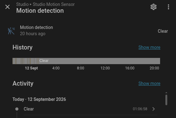

If I click from my dashboard on one of my PIRs I see:

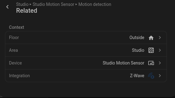

I then click the three vertical dots top right and choose Related and see:

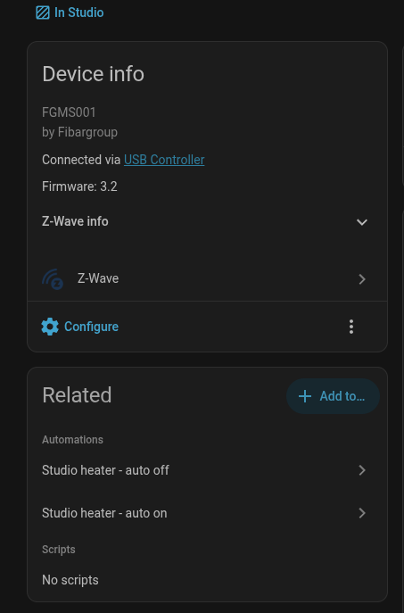

As we see, no automations are listed, and yet if I choose Device info instead of Related I see:
So automations are then listed, why does only the device view show the automations and not related view?

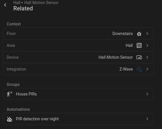

It doesn’t seem consistent either, other entities I pick and then choose Related I do see automations listed, eg:

The automation for the ‘studio heater - auto on’ uses the entity:
triggers:
  - entity_id: sensor.studio_motion_sensor_air_temperature_2
    above: '8'
    trigger: numeric_state

The Studio Heater automations seems to be using only the Studio sensor’s temperature capability (not motion), is that correct? In that case, that sensor’s “Motion detection” capability wouldn’t be expected to show any related connection.
Whereas your PIR Detection automation is using the Hall sensor’s motion capability, so seeing the related motion-related automation connections for it is expected.
Should have spotted that, thanks.
I notice I have an automation that uses the Studio PIR indirectly but it uses an area and I can see the automation listed under the area so I guess that explains this also.
