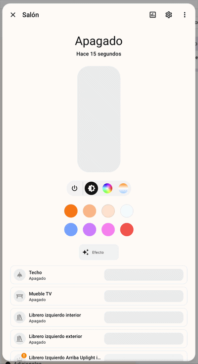

I’d like to share my (more or less) first custom Home Assistant integration. The main idea was taken from this wonderful project: GitHub - oscarb/relative-brightness-light-group: Light group for Home Assistant that maintains relative brightness between lights as group brightness is changed. · GitHub. However, since it is no longer maintained and lacks some features that I consider necessary for this integration, I decided to create my own.
571419037-c2cb4651-b97e-4279-8762-a96722c17bc0
This custom Home Assistant integration that creates light groups with relative brightness control. This integration is built upon the codebase of the official Home Assistant group integration, extending its native functionality.
Unlike standard light groups, this integration maintains the relative brightness ratio between lights when adjusting the group brightness. Changes to color, effects, and other attributes are only applied to lights that are currently on — off lights are never accidentally turned on by attribute changes.

Just trying this out now. Exactly what I was looking for! One issue though, and maybe it is a configuration thing, but when I use the slider to dim the lighting group, nothing happens. I can turn the group on/off, and dim each light individually, but the slider for the group has no effect. Any ideas? I'm on HA Core 2026.5.3.
