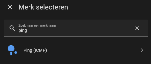

  1. A binary sensor, based on ping, that tells you whether the internet is up. I will follow up with example code in a bit.
  2. An automation that triggers when the sensor transitions from “internet down” to “internet up” that restarts the problematic integration.
EDIT: On point 1, I forgot that you don’t actually need any code to get the sensor up. You just need the Ping integration. It will create the binary sensor for you. I use 8.8.8.8, which is a Google DNS server.

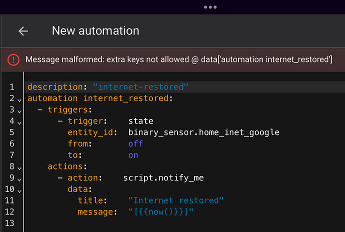

Thanks for this but clearly I am a bit slow on this one. I added the code snippet you provided as an automation but HA doesn’t like it. See attached.

It wasn’t meant to just be copied and pasted. First, make sure you followed step 1 and added the integration. It’s fine if you want to use the name home_inet_google, but you have to make sure that you rename the sensor that the integration creates, or otherwise put the actual name into the automation.
Second, you almost certainly don’t have a script called notify_me in your system, so don’t put that into your automation. I assume you were just trying to get a starting point where the automation is created and then you can tinker with it.
Once you’ve got the “inet” sensor, my recommendation would be to use the visual editor to create an automation that is triggered by “state”, find the “inet” sensor, specify the from and to states, and then pick the action you want it to do. You can peek at the YAML and compare it to the example to get your bearings. This way you get more footing for creating another automation in the future.
The problem you hit off the bat with the example code, which caused the error message, is that that code wasn’t meant for the UI automation editor. I think in the UI, it ends up looking something like this:

So near (thanks to your help), I have created a ping called home_inet_google
