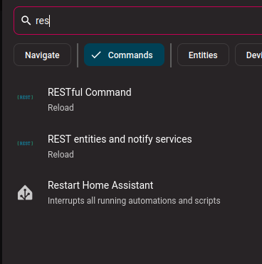

from any main dashboard type a 'c'
then 'res'
then select 'restart home assistant'
I don't think that's the solution to my problem.
The Apple Desktop app needs to reload its dashboard when the screen wakes up. Home Assistant does not need to be restarted.
