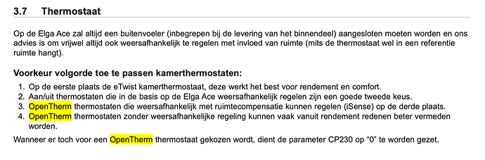

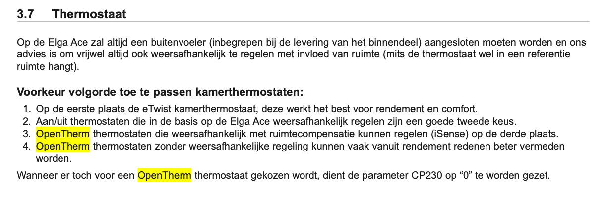

Here’s a snippet from the “Ontwerphandleiding”:
I don’t know enough about the different types of thermostats etc to judge this but I’m not sure I fully understand that list. I get 4. You need the outside temperature to determine the desired water temperature so you can save on energy if it’s not too cold outside. I don’t quite get what they mean with 2 and why it is in front of 3.
I also think it’s perfectly possible to harness the power of home assistant to make something that is at least as good, if not better than the eTwist. If you are only using a naked OpenTherm room thermostat you probably miss out on things like preheating but I bet that can be programmed better in automations.

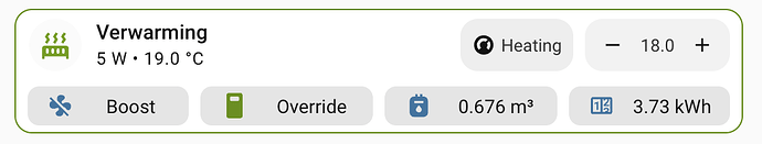

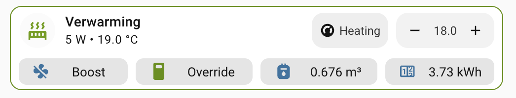

I also use a metering plug for my outdoor unit, at the moment mostly for informational purposes, like showing how “hard” it’s working based on its power draw. I just finished my “heating” card to show it:
The green color changes towards red when it’s using more energy.
The gas usage value is coming from my P1 reader (since it’s the only device in the house that uses gas), the power and energy values are based on the metering plug and a utility meter based on it.
The integration also provides the energy usage, but it’s much more coarse (it increases in steps of 1kWh).
