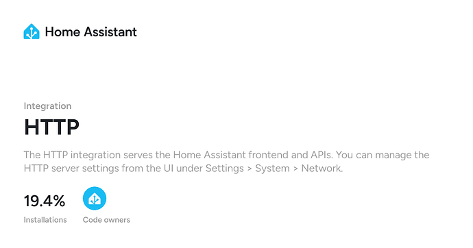

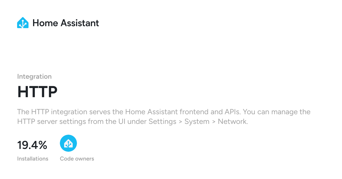

Is there missing documentation or set-up in the App?
Perhaps you need to add a setting in this integration?
