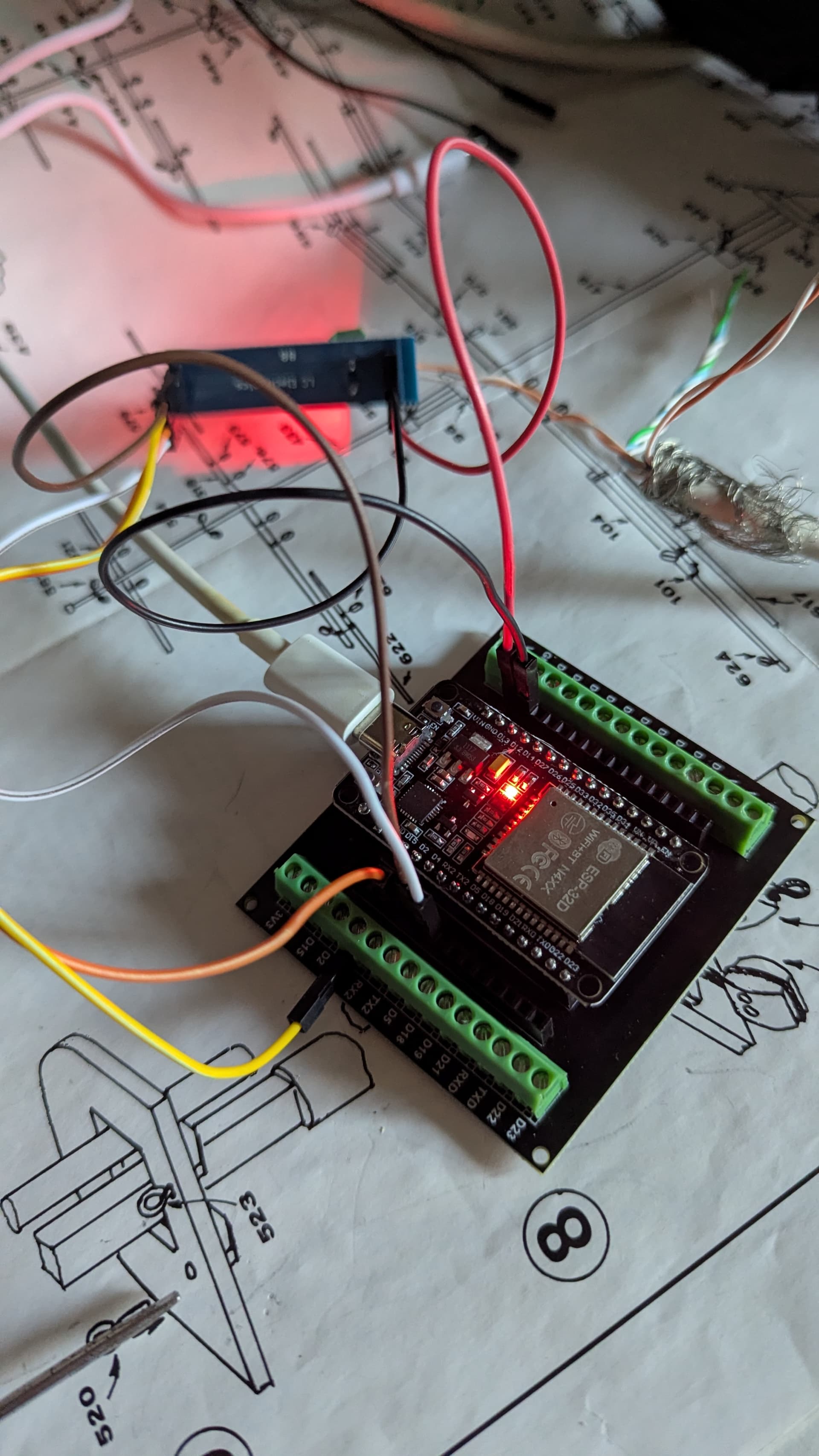

I’m trying to connect my growatt inverter (spf 5000 es) with an esp32 (esp32dev) with the rs485 connector.
So i add a max485 to ttl to be able to comunicate with my inverter.
For the moment i’m still not able to get information from esp32.
I make a configuration over esphome, my esp32 is well discovered and can be accessed by OTA.
First question : is my growatt inverter able to communicate with my battery by CAN and also with my esp32 with RS485 simultaneously?
I would like to keep my usb dongle wifi shine s to communicate with growatt server without modification (as my inverter and my dongle under warranty).

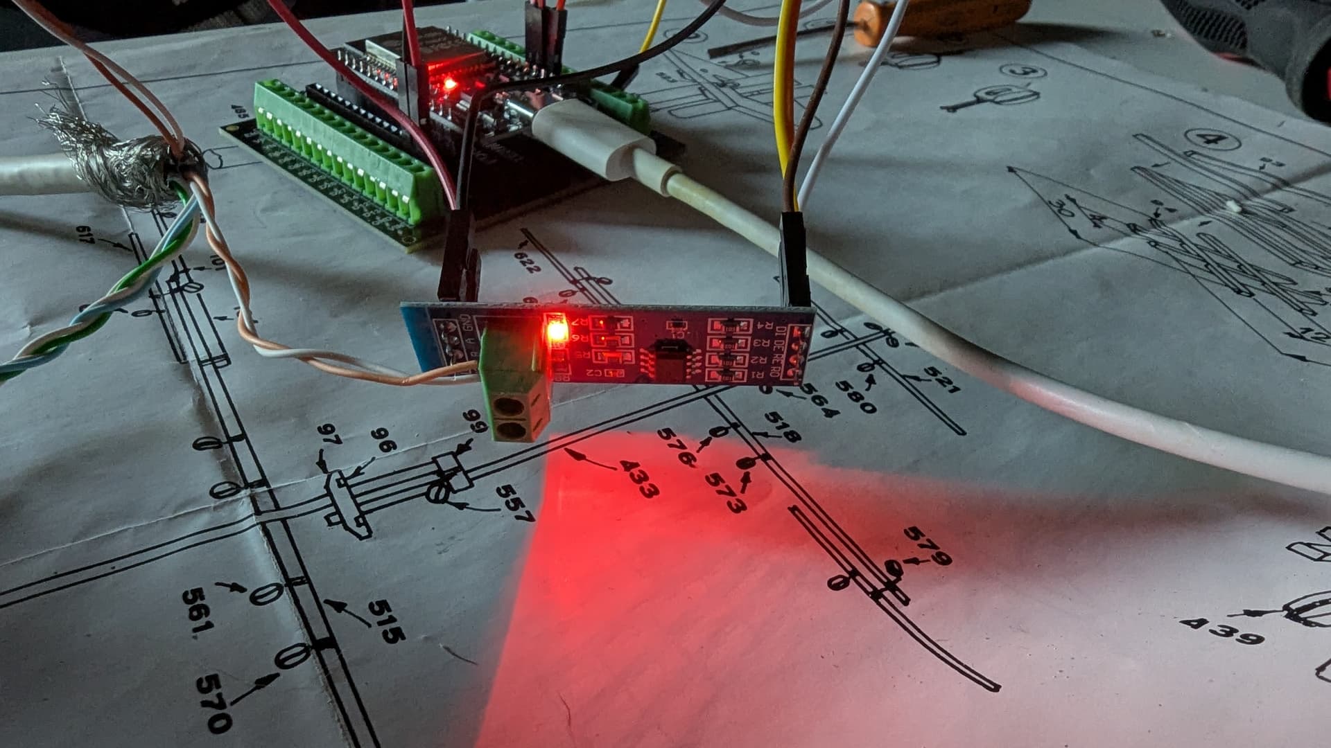

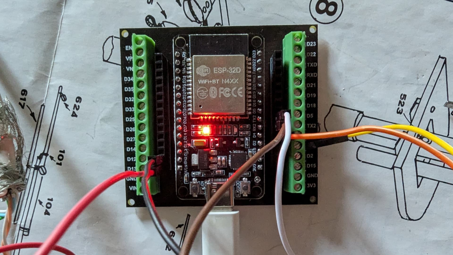

What i did :
  • use GPIO16 and 17 as TX/RX connectors.
  • use GPIO4 as sens detector (as max485 is not able to detector auto-sens)
  • use GND as ground for my MAX485
  • use VIN as +5v for my MAX485
  • on my MAX485 i did connect pin 1 and pin 2 of RS485 câble coming from inverter
In the logs i still obtain “no respond”
Can someone help me ?

Also, how is your wiring? Where does gpio16 connect? Where gpio4? How long, soldered or jumpers?
You should power the max485 at esp32 operating voltage, 3.3V.
Did you try to invert RS485 lines? How long are they? Do you use termination resistors?
The connector GPIO16 is connected to RX on rs485 and the connector GPIO17 to TX, yes i tried to invert them.
The connector GPIO4 is connected on both sens transmit and receive connectors to rs485
I don’t insert a resistor between them, should i do ? If so on which pin and for which resistor value?
For the moment everything is connected by jumpers about 20 centimeters.
The MAX485 is powered by 5 volts from esp32 and is lighting.

Here are some pictures of testing plateform.
Common max485 converters without automatic flow control usually have pins DI and RO… Yours not?
Depends on you RS485 wiring length, if it’s short, keep it without termination for now.
And Esp eventually frying. Go with 3.3V (or carefully add level shifter).

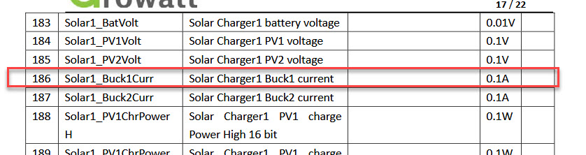

Also, where did you get those register addresses, they don’t make sense to me. Do you have protocol sheet for your model?

register address have been found under some configuration describe in this forum in another topic, but, effectively from some body like me where it wasn’t working…
So where is your gpio16 connecting then…?
GPIO16 ---- RO
GPIO17 ---- DI
GPIO4 ---- DE+RE
i connected to 3.3V instead of 5V it is lightning also, but still not value in HOME ASSIST.
ok, that part is correct
You are far from that, stay with esphome logs. 3.3V power doesn’t solve your problems, but it prevents your Esp dying.

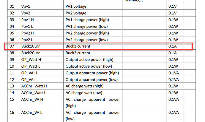

Two things now:
  1. your registers don’t match with this, so do you have some other reference to spf5000 register map?
    https://watts247.com/manuals/gw/GrowattModBusProtocol.pdf

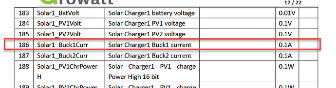

if i take an example (extracted from my configuration) :
- platform: modbus_controller
    name: "${device_name} PV1 current"
    **address: 4**
    register_type: "read"
    unit_of_measurement: A
    device_class: current
    icon: mdi:flash
    value_type: U_WORD
    accuracy_decimals: 1
    filters:
    - multiply: 0.1
the register address to use is in bold in this example ?
and should have been :
or maybe :
