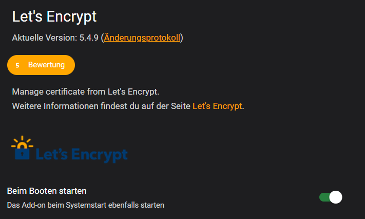

Something seems to be wrong here. HA uses the certs stored in the ssl folder but your Let’s Encrypt stores them somewhere else. Are you using this add-on?
