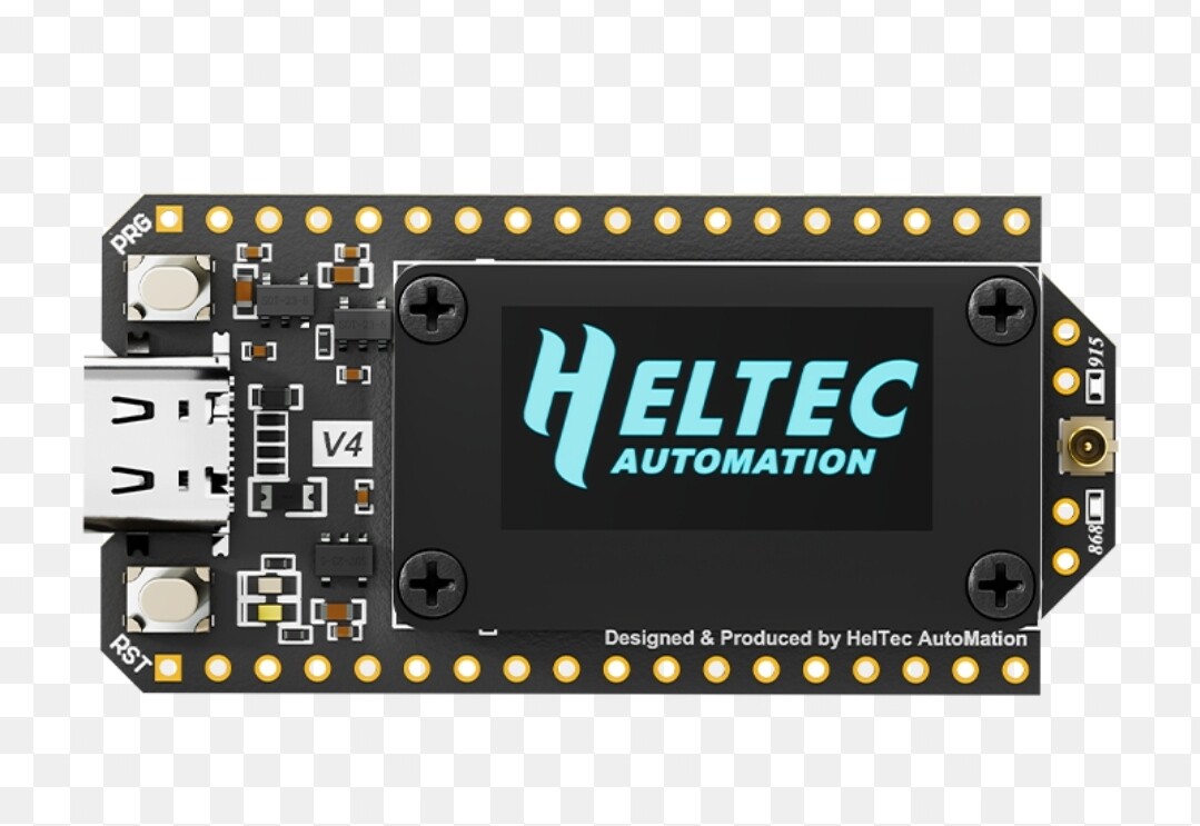

You didnt say how far from HA you park. A 5 bucks 433mhz battery outdoor humidity and temperature sensor may be enough for 50 to 100m.
If you are talking miles away then something like meshtastic and BMP 280. Can run off usb and have a lithium cell. Though leaving a lithium cell in a car you are concerned about temperature is not a good idea.
I can get 20miles with mine but dont have temp module added
