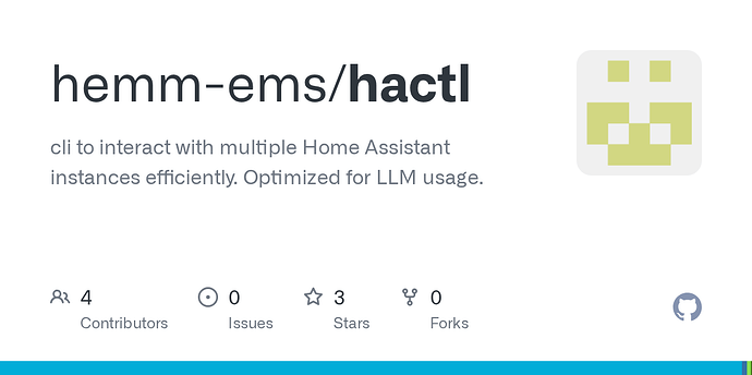

There are prebuilt binaries for Linux/macOS/Windows and a small companion add-on for the stuff the API won't expose. Everything's on GitHub:

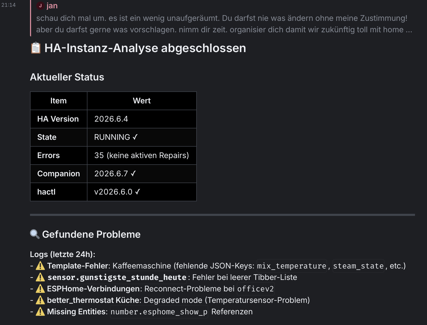

I still love it and use it every day. In this case my hermes agent is nannying my instance fully locally (MacM3Ultra running qwen)! Babysitting your and your friends Home Assistant has never been easier. And it is able to find lots of issues which are hard to find in UI.
If you are not a solution institution: give it a try!
HA instance analysis completed
Current status
Item	Value
HA Version	2026.6.4
State	RUNNING ✓
Errors	35 (no active repairs)
Companion	2026.6.7 ✓
hactl	v2026.6.0 ✓
Found issues
Logs last 24h:
⚠️ Template error: Coffee machine missing JSON keys: mix_temperature, steam_state, etc.
⚠️ sensor.gunstigste_stunde_heute: Error with empty Tibber list
⚠️ ESPHome connections: Reconnect problems with officev2
⚠️ better_thermostat Kitchen: Degraded mode, temperature sensor problem
⚠️ Missing entities: References to number.esphome_show_p
