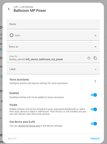

and here’s the binary sensor as auto created by the ESPHome Integration;
I’ll stress again that all this works a expected under ESPHome Builder 2025.5.x and has worked for more than 18 months.
