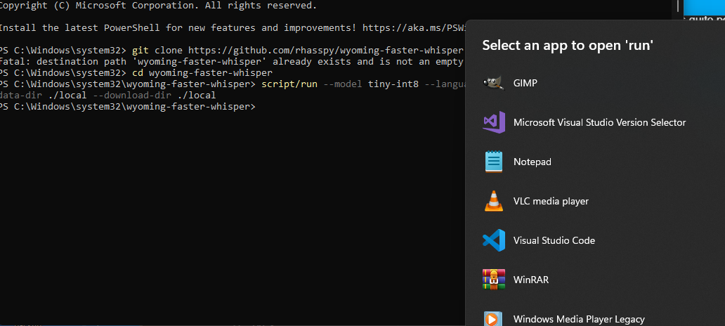

ok, im a total noob to this, tried doing this in powershell and when i paste the script/run this comes up… exactly how am i supposed to run this or are you using something else to run this
