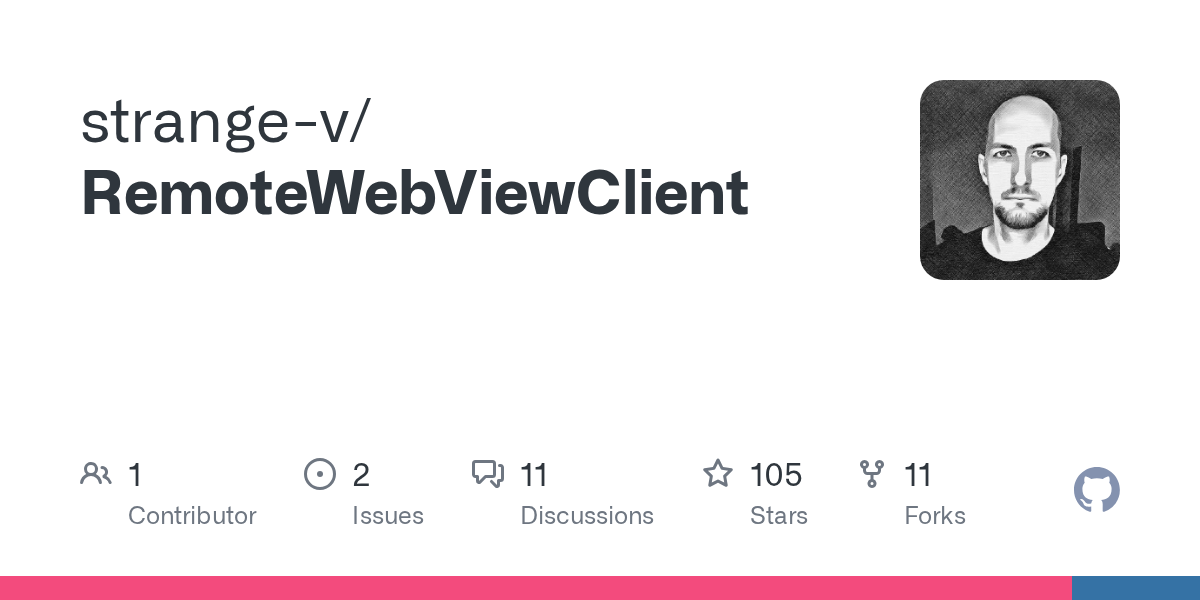

Use “main” branch instead of "hardware_jpeg’. It’s 13 commits behind main and does not include any unique changes. I’d consider it outdated.
TBF, I’m not sure if hardware jpeg decoder is really being used in ESP32-P4 at the moment. But for the moment, just focus on getting it stable, if that means reverting to using a software decoder so be it.
Depending on your LCD resolution, you might want to bump up the tile size a bit. Maybe the sheer number of tiles to manage gives the whole solution issues to keep up?
I’ve had issues with setting ‘min_frame_interval’ to anything below 70. But I feel this might related to the screen resolution. My device has a 1280x800 LCD so drawing a whole frame is time intensive that’s for sure. Maybe you can get by with a lower number but start high and move down bit by bit.

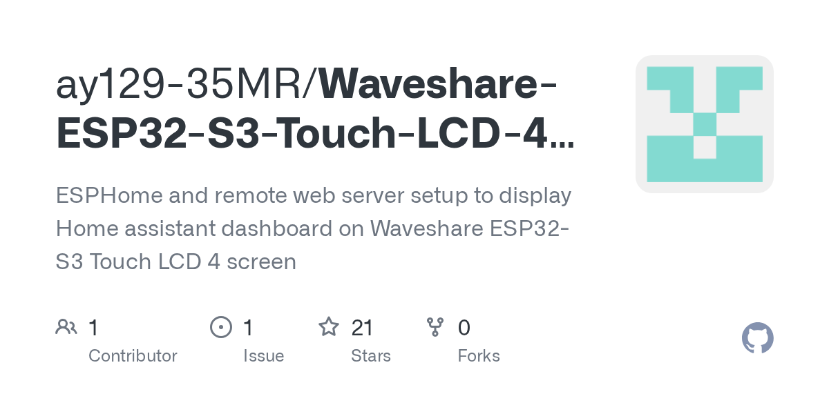

Does anyone have working code for waveshare ESP32-S3-Touch-LCD-4 rev 3.0?
I found this, that seems to be exactly that, but it seems to fail properly setup the screen and ends up with solid yellow color. Maybe something has changed, allthou rev is the same?
