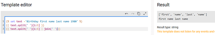

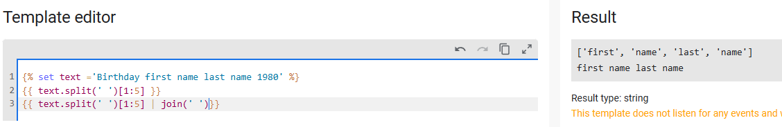

If it always contains the same #words and order, you could split it via space and take the 2n, 3rd, 4th and 5th of the list?
